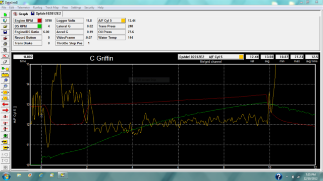

Well guys, I finally got to test my two circuit conversion. I had to travel to Adelaide.
I was surprised at how much fuel the car DID NOT use. The amount of runs I did with driving to the start line and driving back, with the 3 circuit I would have used at least 40 litres.
I was lucky to use 20 litres. \:D/ \:D/
I pulled a plug and considering I drove to the start and back from the deep end, they looked pretty good.
The only issue I see, is I was racing Super Gas. When the stop comes on, the AFR goes rich then lean and then settles down.
My first thoughts are that maybe the cruise RPM is down to low and it's upsetting the carb.

What kind of stop are you using and looks like it's shifting on the stop?
 Post Posted: Mon Oct 22, 2012 2:58 pm
Correct Barry, timer #1 is @ 0.01, timer # 2 @ 1.45 (on that run) shift @ 0.8 sec. I use a Dedanbear ts-6? Disc stop.
 Post Posted: Mon Oct 22, 2012 5:49 pm
Well not sure what that will do to the O2 and it may be normal but I think Bruce (nomad) or could help you as he runs super street.. Thinking I would just run it wide open (no stop) and look at the afr to see how it is and tune from there for best MPH. Then put it on the stop and see what it does then.
What MPH does it run on the stop?? Is it faster than it was from previous timer settings?

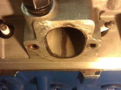

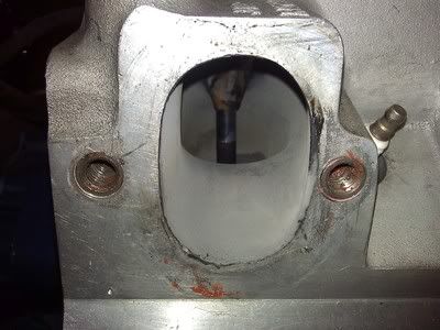

Anyway, when I got home I had some starter mods to do. I had the pipes off one side and I noticed how nice the exh ports looked, colour wise.
In one of the photos I lightly draged my finger in the port and you could see the black/rich colour underneath from the 3 circuit.
Remembering I was driving to and back from the run, no tow car.
My dash was showing 14/1 to 15/1 AFR idleing back, on the return road. \:D/ \:D/

 Post Posted: Thu Jan 31, 2013 9:17 am
From the looks of that exhaust port, I'm surprised you haven't melted the headers off it on the return road!! O:) =; =; ;-)
