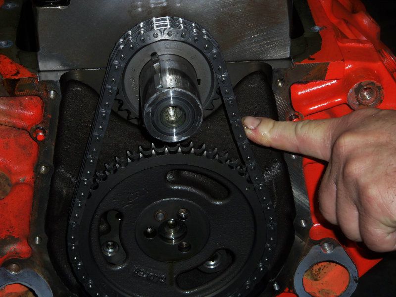

I figured the timing chain would have all kinds of slop in it. This is my Cloyes true roller after 325 licks.
Other parts looked good, too.
There is some excessive wear on the cam lobes. The pictures I took of that were not good and couldn't be posted. WE'll be talking to Bullet after the first of the year.
I spoke to Darin Morgan about my cylinder heads. After giving him the particulars of my engine and it's intended usage he suggested I not alter the heads. Just freshen the valve job and go. He a;so suggested I got to 1.8 rocker arms, which I will do.

Bruce, I would replace that chain set with a machined gear on the cam instead of that cast gear..I had one to start to loose the tips of the teeth found them stuck to the magnet on the drain plug.. It was a PIA to replace it in the car...

Actually Barry, we're going to replace it with a belt drive.

A belt drive is worth every penny just for the ease of cam timing adjustment, especially if it's going on the dyno. We are able to change cam position faster than changing jets. =;

I'm surprised that chain was as tight as it was. Kevin wasn't. All in all, the only place I was concerned was with the cam lobe wear.
My plan is to work out cam timing on the dyno. We're going to use the newer Jesel solid upper belt gear. We won't be fiddling with this that once the dyno session is over.
In all honesty, I don't expect anything we do with this freshen will make this engine any quicker than it was. I'm just looking to make it more durable and enhance it's ability to go longer before the next freshen up job.
