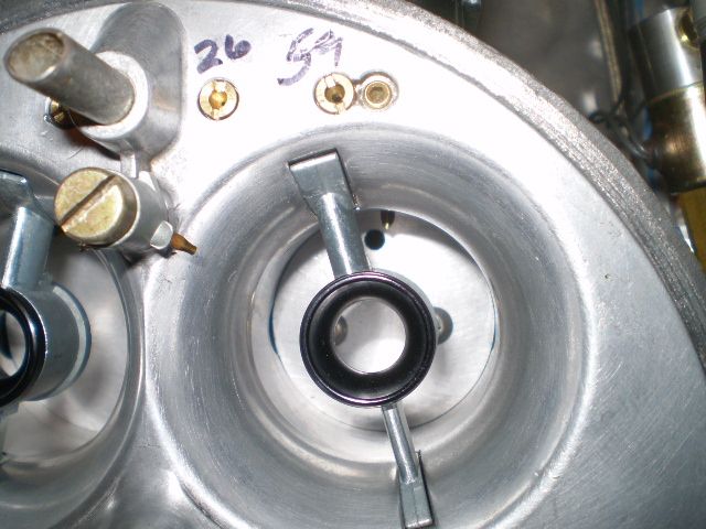

After reading this a few times :- I am willing to try a few things with my E85 carb as I am having issues with idle and some cold cyd's threw out the run.
I will post a picture later today of where the holes are and these are .095 in each blade as this is a 1250 HP body that has T-slot showing with the blades fully closed.
What I was thinking of doing is put a small hole where it usually goes and another hole on the other side of the shaft. Not sure what that will do and never did it before and also never seen one done like that either so it will be a test.

 Post Posted: Thu Aug 09, 2012 8:34 pm
Can't edit my post but here is the hole location in the throttle blades..
 Post Posted: Fri Aug 10, 2012 4:43 am
Split the difference between the idle fuel discharge hole and the Tslot
