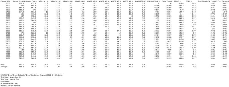

I finally got to dyno my SB2 yesterday and test a few carbs and fuels. No timing or cam timing changes, may be a little there yet, but wanted to get some carbs in the ballpark. Thanks to Mike Laws and the staff at BLP, it was a really good day overall. These are the highlight pulls of the day.
Baseline 1250 on Sonoco Maximal, same carb I dynoed with the first time with this engine. Looks to be around 16 HP and around 25 ft lbs better, I think the cam change did most of it.

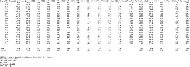

This was the best pull of the day, a QFX body 1450 I machined a bit on the venturi to lower it. Q16 for fuel.

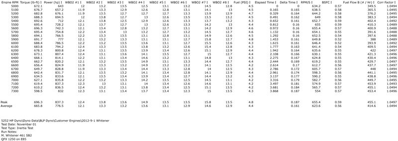

1250 on E85. 15.5 to 1...
