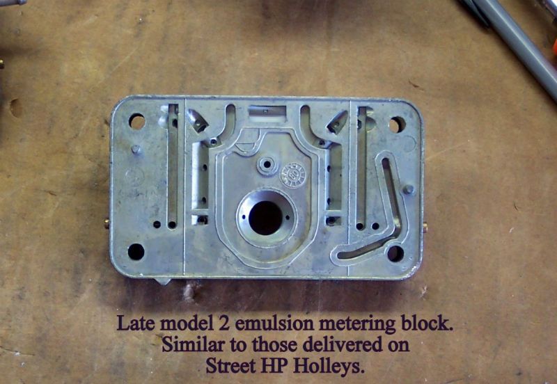

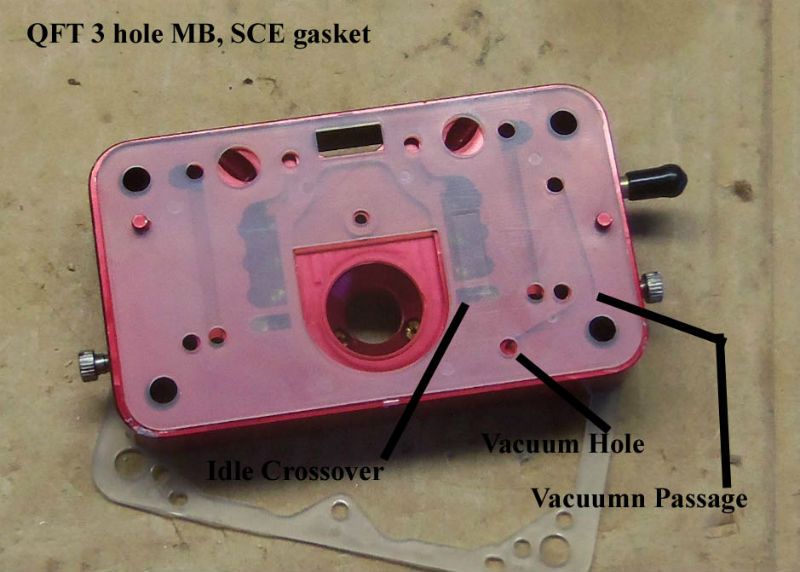

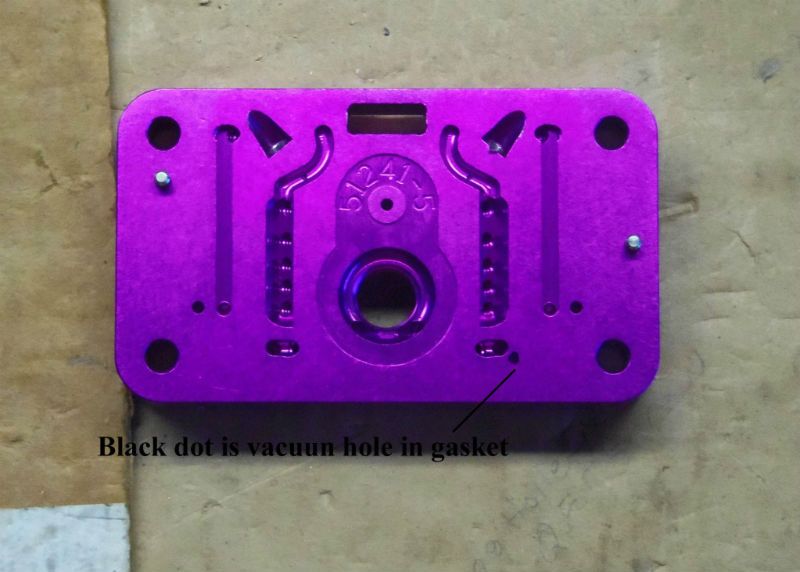

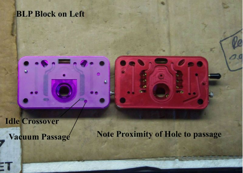

Pics!
Standard 2 circuit block
QFT 3 hole block w/ vacuum provision
BLP and QFT block comparison. Look how low the BLP idle crossover passage is.
BLP 5 hole block. See how close the hole in gasket is.

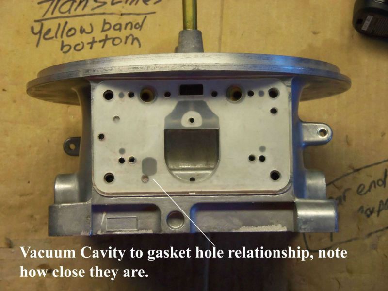

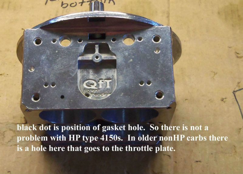

4500 mainbody. In oldstyle 750 Dominators the bottom of this cavity is drilled for timed vacuum. Works well at vacuum. As engine speed increases vacuum sucks gasket back and opens bowl to manifold vacuum. Instant 5th jet. NonHP 4150 carbs may also have this problem.
Hp type carb has no drilled passage.
Solutions are:
A. fill 4500 cavity with epoxy if required.
B. use only BLP or QFT gaskets.

Bruce my 7320 & 9377 has that vacuum cavity but there is no hole to the throttle plate..
