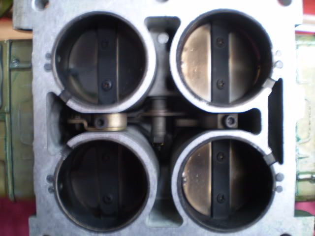

Had this happen yesterday on a Dominator I was reworking, the carb was no more than a year old, a name custom build, but not performing well. Kind of rushed to turn it around, I neglected to check the linkage and throttle plate screws. Bolted it on my engine to test... Silly me... ](*,) Everything got pulled and red Loktite. And two throttle blade screws were about 1/4 turn loose as well. [-(
Good news is it came out, I still need to do a compression check. If it checks out I may be good with only screw marks on the piston and quench of the head where it was stuck.

You didn't have that stuff loose did you? I mean, it was like that when you got it from someone else, right? :-k
I had heard of this happening before but never knew anyone directly involved. Now I do. [-( Lets just hope that you've dodged a bullet and not collapsed a ring land.

Oh, and for the record. Mark didn't do anything to cause this as it was like this when he got it from the owner? :-k
I guess it never hurts to check though, hey! And I'll bet that will be on his checklist from now on! ](*,)

By plate screw do you mean for the butterfly? The screw in Marks pic looks like a linkage screw to me, something a safety plate should catch.

I normally have a 4 hole plate for my cable to attach to, this carb is a 2.190 throttle blade, I had to use a custom open spacer to test with to clear the butterflies. I did a compression check this morning, that cylinder is down 50 lbs and after more pics with the inspection cam I see where the screw got between the intake valve and seat. Guess it's time to put the SB2 back in... What I can't figure out is why Holley linkage was used. It is cheaper when building from scratch as this was to use an external shaft setup and eliminate the linkage.

Yes Chuck, I have heard of them falling out and doing the same thing. Safety plate won't help them

The screws in a "factory" Holley are staked on the threaded end after they are installed. I try to do that also on the ones that I remove and reinstall butterfly screws on. That and some Locktite.
