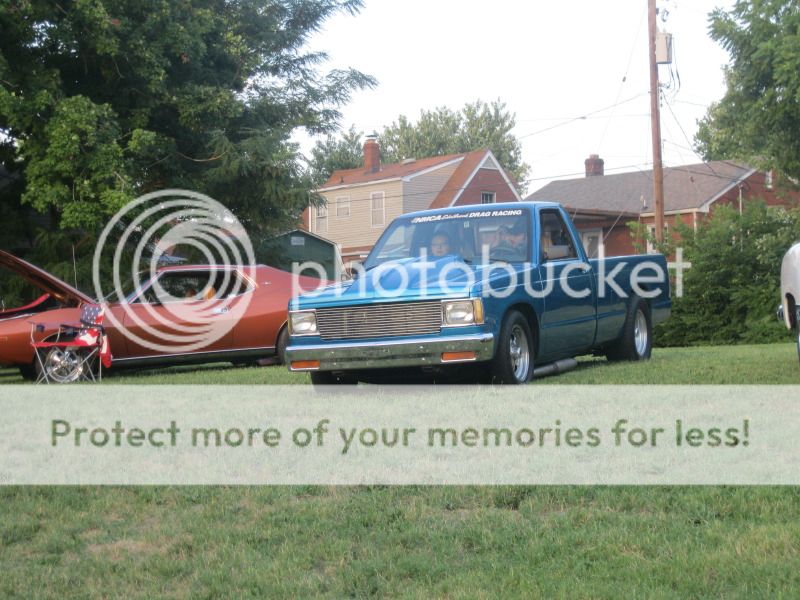

Here are a few pics of my S10. I originally put it together to run Pinks All Out back in 2010. Take it out 5 or 6 times a year, mostly to the grudge night races.

Took the truck out last Saturday night. A few months ago I swapped converters from a semi-nitrous friendly 3800 stall speed, to a tight real nitrous 3400 stall converter. I also made the mistake of putting on a new Super victor 2 intake at the same time. The old rule, "change one thing at a time" is very true.
The old 10.15-132 n/a passes are history. The truck would not run in the first 60 feet. Tried all sorts of things, but nothing helped.
So last week I put the old SV on and played with the carb and got it to run 10.50-129.9. It still sits on the converter for 60 feet, but the a-f is more in line.
Ran a nitrous pass at the end of the night, 1.49 60 foot, 6.13-118.4, 9.50-142.4. Progressed in single stage on a 73n jet. Pretty happy with that pass for such a small jet.
If anyone is wondering about the spread between the 1/8 mph and 1/4, the 1/4 mph clocks at Sacramento are about 3 low. I can run the same 1/8 mph at Sonoma, but 3 more MPH in the 1/4.
Crazy how even on spray, this converter pulls down the engine. Never had a converter this tight before.
