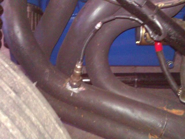

If this is an open header exhaust, tell me where your sensor bung is welded in!!! :-k

Ken, yes it's open header. With the idle AFR I wanted to make a change and see the results on the (Racepak)screen. I started @ .065 in the IAB and went down to .058 and saw the AFR come down. I was happy.

I can move the o2 sensor to one of the middle pipes, but that will be later on after I get a base line.

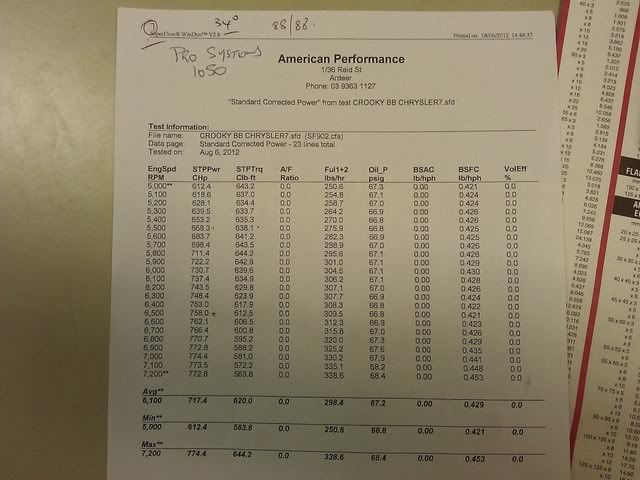

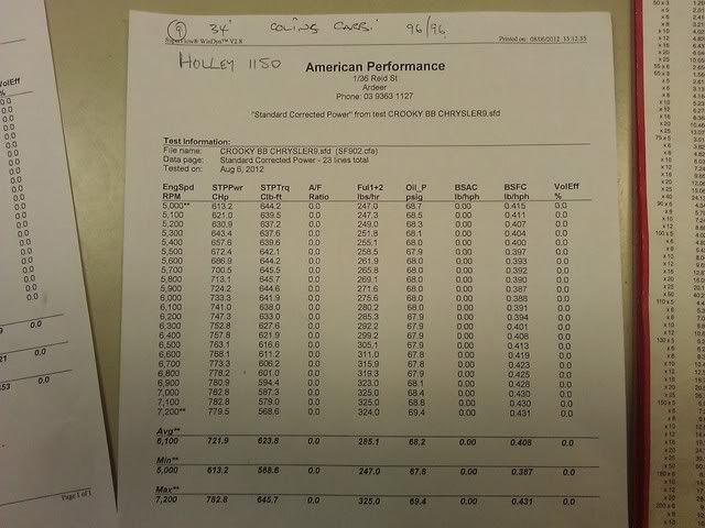

Well my mate had his dyno day. It's a 500 ci BB Mopar and I think the power it made, he was happy.
As you can see it made the most power with my carb, not his Pro Systems, although the PS is a 1050 and mine is a 1150. The dyno operator was saying "Pro Systems are the best, every thing else is junk"
so he was a bit surprised with my "junk" carb. He also was not able to get the A/F to print out on the dyno sheet. Mine was closer than the PS. I did have to jet up to #96's
Have a look at the sheets and tell me what you think. It looks like mine made more power using less fuel.
What do you guys think about the BSFC numbers? I thought mine droped a little low. The Pro Syetems was a little high.
Cheers Colin.

Looks good to me and your junk 2 circuit is working better than the POS systems carb :-# ..

Ok so I'm going to be the spoiler here and ask, how much tuning was done on that PS carb? What I mean is was this the BEST that your dyno operator could get out of it? :-k
Not that I'm a PS fan BTW, just want to make sure we're comparing apples to apples is all! ;-)
Cheers Colin.
The important part is that the average HP and TQ were up. This is what gets you down the track.
Like Ken I want to know did you guys tune on the PS carby? I didn't look at the BSFC before I started posting so I'll be checking back.
You'll be happier with your carb I'm sure.
Okay, I see the BSFC is lower with your carb by a significant amount. So on the dyno at least, you're making more power on less fuel. If your dyno operator has saved your pulls, take a look at the graphs for A & B fuel flow to see how equal they are. This visual is sometimes better to see that a column of numbers.

This guy is a good mate of mine, I went with him on dyno day to help him. He even organised it to coincide with my RDO. I even built him some new headers for this engine.
I took my carby to compare before/after conversion.
When I had my engine on the dyno earlier in the year, I also had his carby to try against mine when it was a 3 circuit.
But I am happy that mine (home built) turned out better than a store brought. ;-)
With the PS, we only changed jets. It was specifically built by Pro Systems for this engine. My mate got up in the middle of the night and rang and spoke to the main guy, Patrick I think, and gave him all the spec of the motor, cam, comp, engine size, car type, fuel type, etc,etc.
Also I didn't want to open it up to many time on the dyno because I felt the bowl threads in the main body where not to good, they will strip at any time. They where like that from new. Something I will have to fix later.
From memory the A/F ratio was very similar on both carbys.
I will try and get the A/B fuel, I did see it when we where on the dyno.
