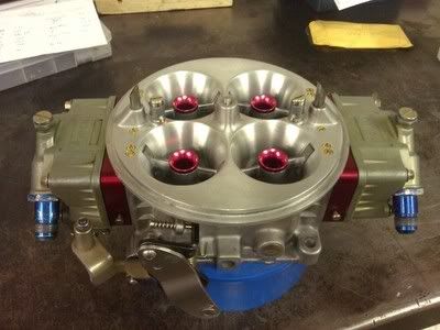

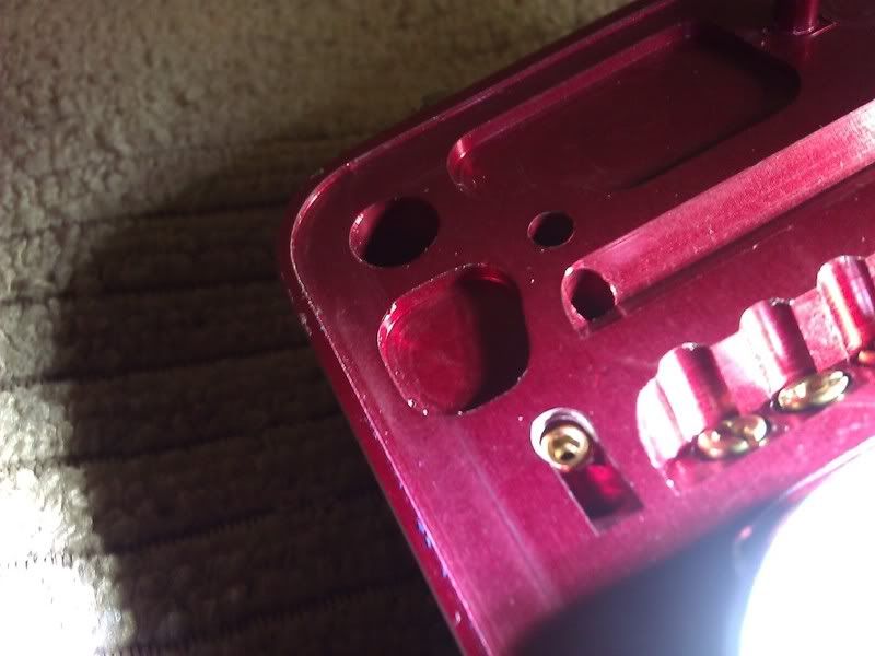

Thanks Barry, that was going to be one of my next questions. So anything past a square T slot and I will have to drill the butterflies.
I don't know if you can tell from the photos. The outer air bleeds are just blanked off.
Also more photos.

Colin, You can also plug those bleed holes with a 10/32 brass set screw if you have them as the HP bleeds are not cheep or you don't even have to plug them at all as there is no hole in the metering block gasket..I had 2 HP Dominators and still have one but there quality control is in the toilet as far as the T-slot is concerned. You maybe lucky but you may have had the slot exposed a lot before and didn't know it :-s ..My 1150 Non HP had just a touch of the slot exposed and after I was done with the on and off thing I ended up with 4 7/32 holes in the blades to get it to idle where I wanted it to.

Colin after looking at your metering blocks you need to make sure that your IJ doesn't go too far into that hole. You have to make sure that there's plenty of room on the inside for idle/transition fuel to enter that idlewell.
You might be OK but I just thought I'd bring this up as it's possible to have that IJ in too far. If you need to have it back out some, then you can use a small punch to "ding" the top thread on the set screw to hold it where you need it in that threaded hole. You can also use that trick on Ebleeds. ;-)

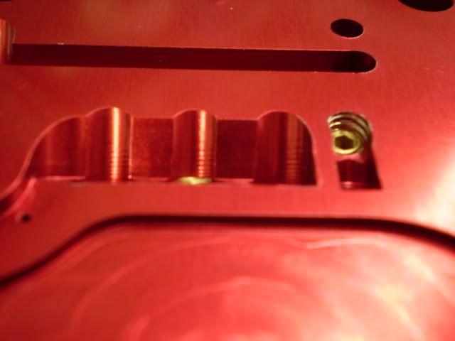

After look at it again it may be the picture but here is what they should look like just flush with that cavity.

you had me worried so I went and double checked the IJ. I used a bottoming tap, and only tapped just deep enough. They are only 5mm or 3/16 long so they are definetly not to deep.

I took these photos with my mobile phone, thats why there not so good.

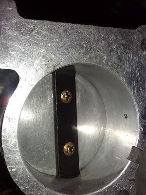

Hey Your IJ looks just fine! Your lucky the have a Main Body like that!!!!!! Mine was showing with them completely closed. I am thinking your not going to have to drill the blades at all and maybe lengthem some O:) Here is what I had to work with :-

Colin, here's a little tip for ya on the T slots. Get that carb on the engine and running at idle BEFORE you do anything with the T slots!!!
Once you have idle speed where you want it, then pull the carb back off and check the T slots. If they aren't showing at all, then take a scribe and scribe a line where the blade is in the bore at the T slot. That way when the blade is open you can see exactly where that slot is. If it needs to be lengthened, then don't go any further than that scribed line, THEN you can file a little off the blade in that area to expose the slot. This way you're leaving yourself sort of a safety zone down the road, ie, you can replace those blades, but you CAN'T put material back in that slot! ;-)
