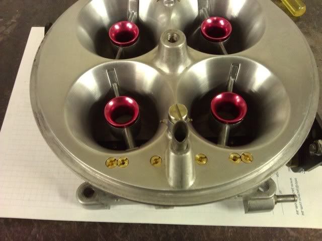

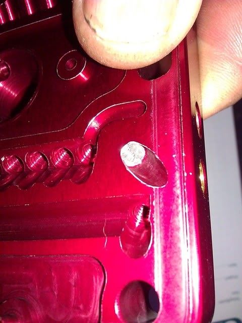

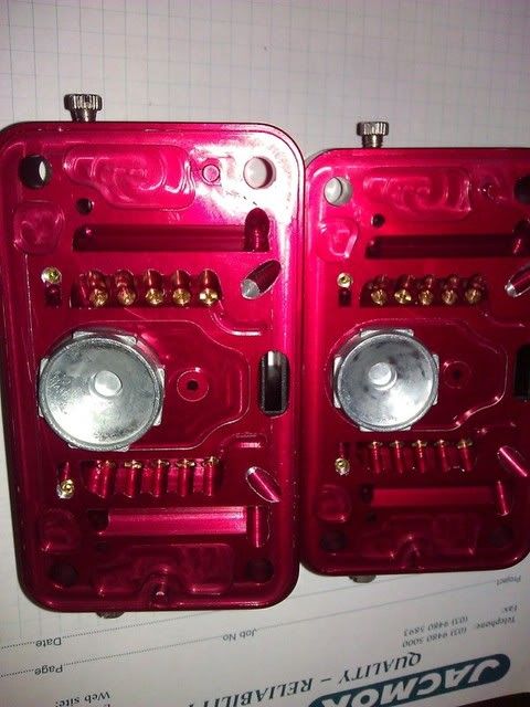

Well I got the conversion finished. Using the QF metering block made it real easy, I only had to drill the cross feed and lower the IJ and drill some bleeds.
The longest part was waiting for some brass set screws to arrive in the mail, superflowcarbs on ebay came thru for me there. Side note Mcmaster Carr won't ship to Australia, I tried.
So I'm going to wait to the weekend to start it up to get idle and transfer slot exposure sorted.
I will do a telemetery session on the Racepak. I can move the o2 sensor around a couple of the primarys. So I will have some data to share.
Unfortunetlly it's Winter here so I won't get to the track for a while.
One of my mate is building a 500 something cube Mopar and he has a 1050 3 circuit carb, it's red and shinney (not QF) and he doesn't beleive in the 2 circuit deal. He's heading to the dyno soon, so I'm going to give him my carb to try.
I had my engine on the dyno earlier this year and I know that my carb (prior to the 2 circuit conversion) was 10 better thans his carb.
I want to say thank you for all the help so far, with out it I wouldn't have attempted this.
I will try and attach some photos.

Looking good Colin, You want to mark your Speed screws where full closed position is and then crank them open to where there is a square T-slot is showing.
This makes it easier to see where you are when doing the first start up. That way you will know it you will need some by-pass air or not...
Another tip is to remove the acc-pump cams after you get some heat in it as that makes it much easier to make adjustments to the idle...
Good luck!! and again Nice job =;
