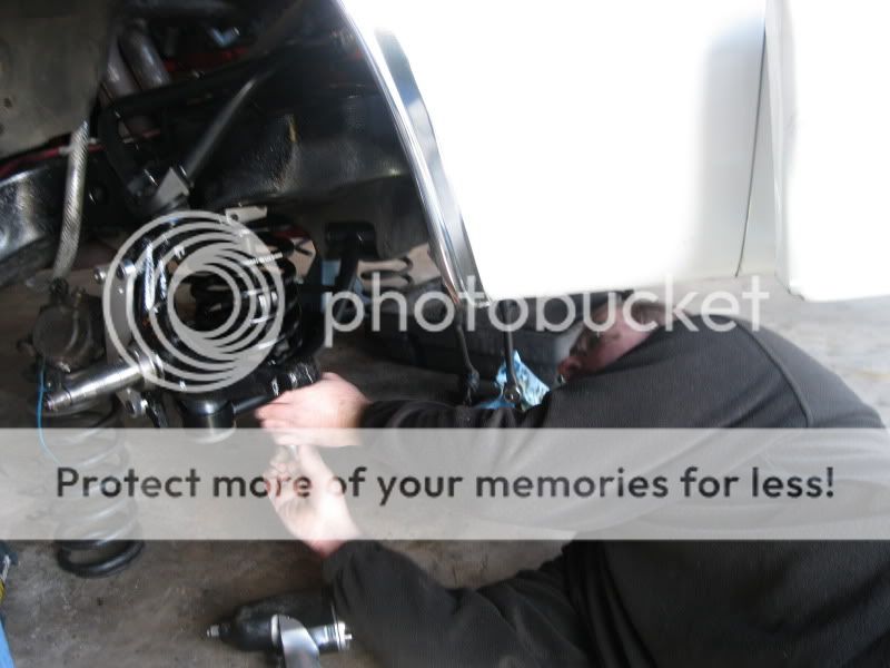

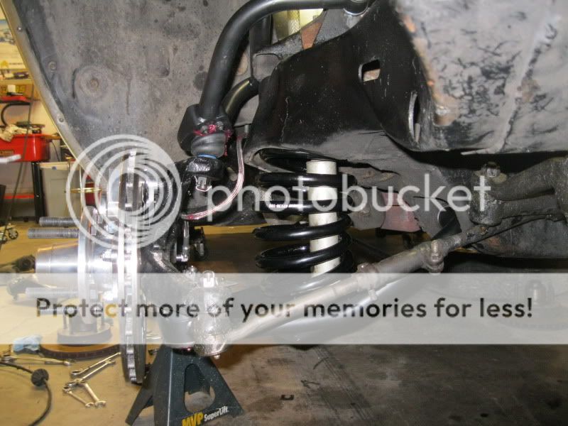

Today we started the suspension up grades. Jake works half days on Tuesday's so he got started. He had to be back at work by 5 for a meeting. He had his side done. After supper I started on the driver side. It is stripped and ready for modifications. I ordered the springs this morning. I'm taking the spindles to Kenny Grimes Racing to cut and tap the new holes. Then we will set up the brakes.
Of course the big guy gets the smaller area to work in [-( [-(

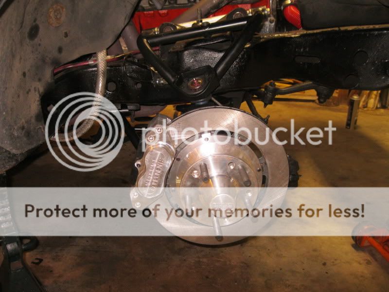

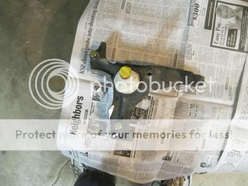

Aerospace prostreet brakes, TRZ arms and Trick springs. They had to cut the old Caliper mounts off the spindles and drill and tap the shield holes for the caliper to mount to. We wanted new springs to help pick up the front. The old ones had been cut about 1 and 1/2 coils. We went with the vented disk cause of weight and safety.

So your using the old dust shields? and if you didn't use them would you still have had to cut the spindle's?
Something doesn't sound right :-k My kit went right on more less with no rework to the spindle's at all :-s

This is where it had to be cut and tapped. The bolts ar in the holes that were tapped.

Jake at work. ;-)

Hey Steve looks good. Did you weigh everything and see the actual difference?
Suppose to be close to a 50Lb savings from what I see if you use the wilwood brakes I see yours are aerospace and I would think they would be close..

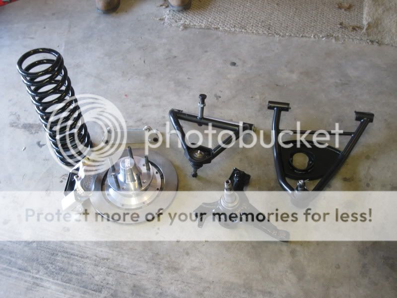

Lower arm Old 14.5 New 7.5, upper arm 7.5 / 5, rotor/hub 19.5 / 15.5, spindle before 12 after 11, caliper 6.5 / 1. right at 20 per side. not as much as I planned but close enough.

Win some races \:D/ \:D/ \:D/ \:D/ LOL It sits higher in the front about 2-3 inches above the tire right now. I got thinking that before when it came down the front end hit the bump stops and bounced back up in the air a little. My be unloading the rear tires a little. Maybe this will stop that and pick up some ET. Thoughts?
