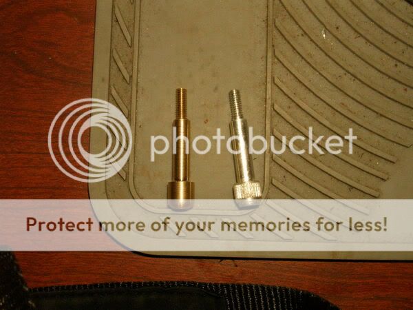

my thought was to remove carbon center and then i would machine a brass insert and press fit into to cap.

finally got around to making a brass insert for my cap. guess time will tell if it works or not.
