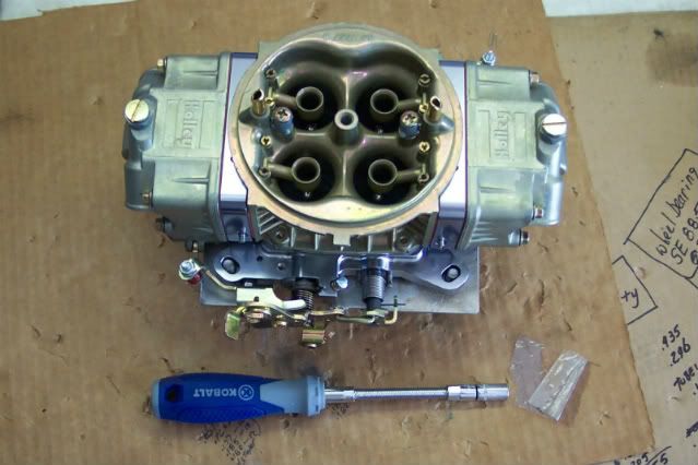

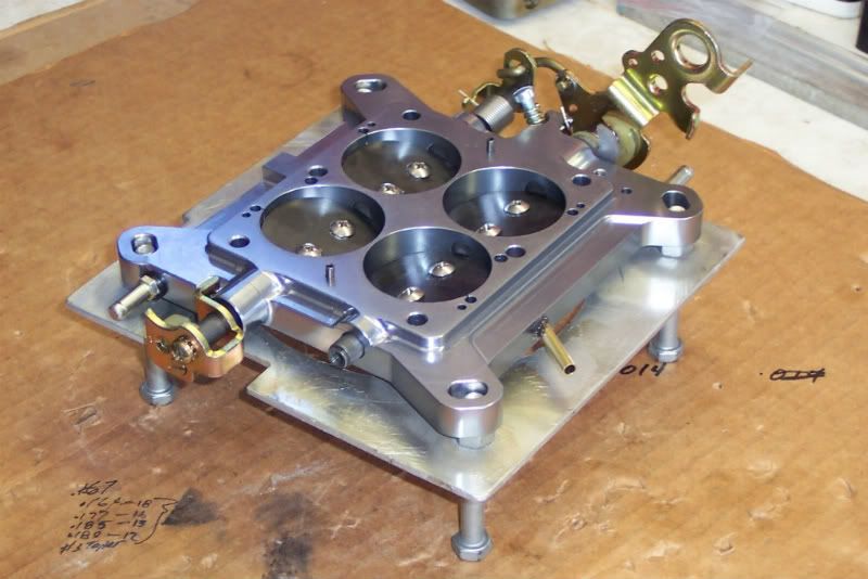

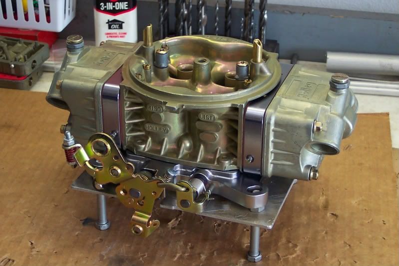

I've finished our new shop E85 950 HP. BLP alloy baseplate and metering blocks with Braswell booster. Notice the baseplate is a dual pattern for 4150s and 4500s. Costs a dollar more.
We don't expect to be back on the dyno untill after the first of the year.

Nice carb stand Bruce =; .......Do you sell them too =;
 Post subject: Re: Another E-85 Convert
 Post Posted: Fri Nov 25, 2011 11:17 am
Sorry to say I don't sell them. I made that in the early eighties out of a stop sign I found in the scrap pile at work. There's hole you can't see that's the size of an aircleaner. I can flip the carb over and work on the bottom. Pretty simple stuff. I'll post a photo when I can.

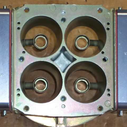

Bottom side of the 950 sshowing the Braswell boosters.
