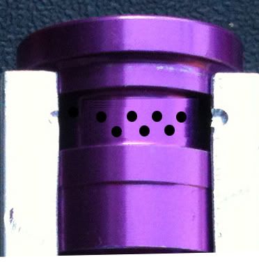

It will be a price issue I imagine, since Holley does not sell many the price is higher. I know Mark Sullens uses the Pro Comp blocks and modifies them to his liking and they are cheap. Also saw some interesting booster inserts last time down at BLP, similar to the picture below I painted to look like them. They had two rows of holes all the way around staggered, top row just under the step on the inside. Possibly a candidate for Alcohol, and a mod you could do to stock boosters to get more fuel through.

Mark those blocks are 5/16x32 thread, which is the large one. Mine has those which is another reason I was trying to find a source for them.
RE: More holes in the boosters? Not sure about that as there's only so much signal available and if the fuel channels are small then more holes might be moot point. Also remembering that Mark S figured that you needed 40% more area in the booster holes than in the banjo feed hole. That's something I'm working on with this alky carb but I'm not sure that the 40% number is what it actually will want for methanol since the fuel requirement is 2.3 times greater. I've got 12 holes that are .081 as there was no .080 drill available.
 Post Posted: Tue Feb 15, 2011 2:21 pm
I think the above booster would be good for methanol, no chance for a restriction, as long as your other passages are big enough. I do think BLP resorts to the wide body 3 circuit block with methanol on a Dominator, easy to add fuel to the intermediate circuit and no idle feed tube restriction. One of the guys there that built an E85 carb for his brother-in-law used the wide body 3 circuit blocks. I would prefer to use a 2 circuit as long as it will pass enough fuel and maintain a high enough signal to pull the fuel, make it leave at the booster where airspeed is highest.
