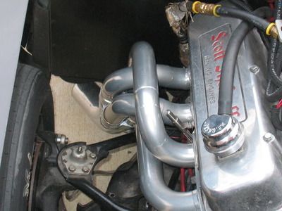

 Nitro Plate did my headers. Very Happy!!
_________________  427 BBC 6.395 @ 105.36 1.355 60'
Elkyman
Posted: Thu Dec 30, 2010 6:16 pm |
Joined: Sat Nov 03, 2007 4:44 pm Posts: 1423 Location: Clawson, Mi.
bigfoot385 wrote:  Nitro Plate did my headers. Very Happy!! Thanks bigfoot, looks like a real nice job on them tubes
