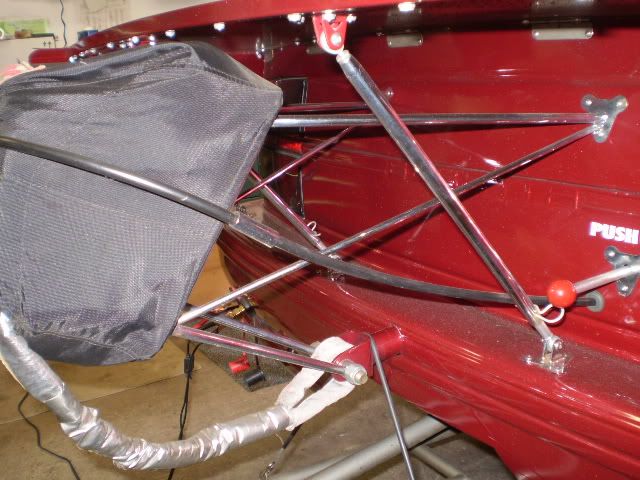

John you need something else to hole your chute cable...Looks like it's just held on by the bumper???
Thinking it need a bracket/tube to go threw by the tube that holds the chute..
I will see if I can get a pic of mine later..
 Post Posted: Sat Jul 17, 2010 8:34 pm
Here you go..Look where the cable comes out of the rear panel and goes to the chute. About 2thurds the way it goes threw a small piece of tubing to support it then goes the rest of the way to the chute..
 Post Posted: Sun Jul 18, 2010 3:10 pm
Your right Barry, I drilled a hole in the bumper and ran the cable thru a rubber P-clip and it is secured to the frame underneath also at one of the frame rails. Funny, I was kinda looking at the cable and I don't have anything that I can use to make it more straight up to the chute and keep it supported :-k let me do some thinking on this, and thanks for the pics. ;-)
 Post Posted: Sun Jul 18, 2010 5:22 pm
I just checked the rule book online Barry, and your right again, I need to make some kind of a bracket that can come off the main chute holder tube out to the side to secure the cable withing 12" of the release cord on the chute ](*,) darn, more work to do now :- I will make something that will work, and the rules also state that a ball lock pin is prohibited too O:) and guess what came in MY chute mounting kit? yep, a ball lock pin ](*,) still more work :- Tomorrow, racing is on TV tonight and I need a break. ;-)

Yes on the vega there is a small solid tube with a hollow tube the cable runs through that holds the chute cable.I'll try and get a pic tomorow for ya.Unless you already fix-ed dit... =;

Thanks for the kind words, and I sorta made a little tin bracket coming off the back of the chute bag screws that goes out to the side with a nut & bolt clamp thingy, looks kind of gayish but it holds the cable, and the inner cable releases from the chute just fine. Although Tech may not approve of it being so flimsy, but it works, so they may just pass it anyway. I will make a more fancy one up later on like Barry has in his pic, and I have seen a few others and now I see how his is setup. I got more info on cable length also and I am all set up to pop the laundry when needed, or to try it for the first time.
