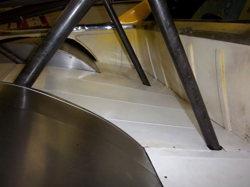

Hoooopaaaaa =; Problem solved on the possible tweaked chassis. The driver top 4 link bar was so tight when we were setting the wheelbase that THAT is what caused the right front to nose dive down so much. Glad that is all good now. Here is some pics and just some bed tin is left to do and then add some weight, dbl check the wheelbase, change the pinion angle and set the 4 link bars up for a starting point for an I/C spot, and find the C/G of the car and I am taking it home, hopefully this Sat.
Thanks for all your support and info guys, seeing truely is believing. \:D/ \:D/
