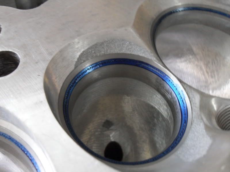

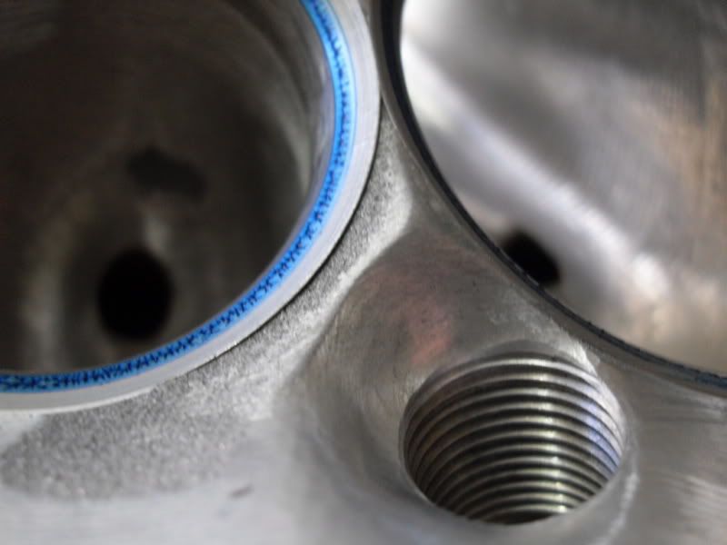

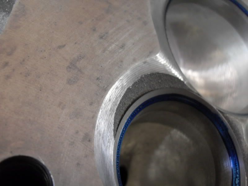

I dont think I will get away with a simple blend it in, I just blued up the seats so I could get a good idea of this top cut, I think the top cut will be gone by the time I blend it away. Here is a pic of the problems. Do you think I should take it to the local valve guys and get that top cut taken down until its perfect and then get all the others done the same amount and then have the seats re cut. I think I would be happier with that and then make those two polishing valves. Do you think I would be better of doing that, or should I just move to the states lol.

How many chambers/seats are like that?
Are the bad seats all exhaust?
Are they all similar to the pics in the amount of circumference that is sticking above the casting?

Hi Rick
All the Intakes are ok, I can blend them in as per Mikes directions plus the casting is above the seat. Its the no 2 and 3 exh on both sides that is the issue with no 3 on boths sides being the worse as in the pics.
Should I sink the inlets down as well or is it ok to have the exh sitting lower than the intakes.
