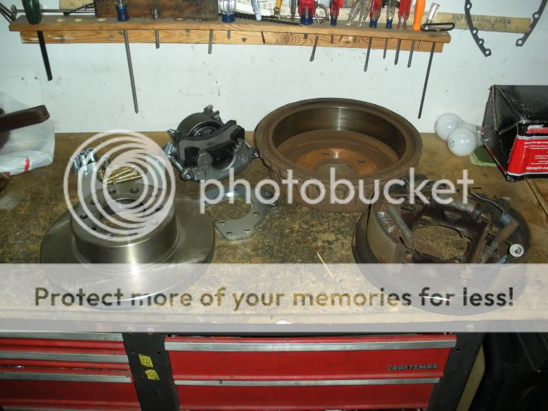

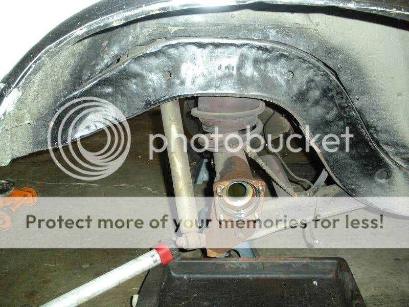

Here are the pictures.

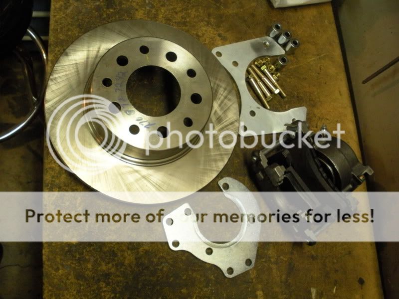

These are the 2 kits.
The disk kit weighs 24 lbs, the drum kit weighs 21 lbs. The rotor and drum both weigh 13 lbs.

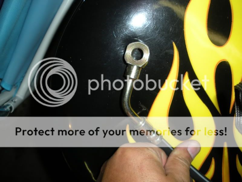

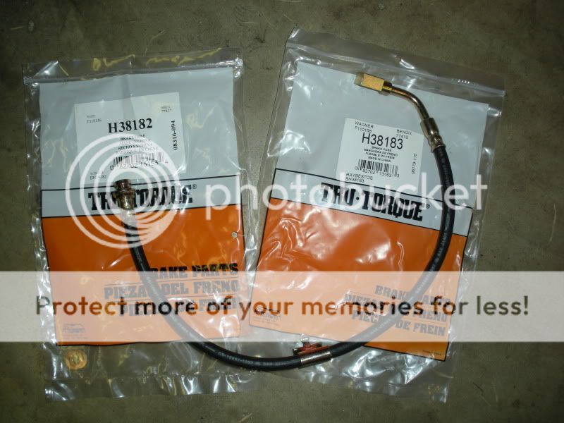

Brake lines we a pain due to bracket bolts and the location of the inlet. I went through the hoses at Advance and these were close to what I need.

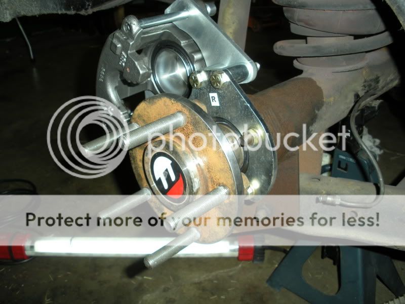

I had to grind the edges off. I also had to bend and twist them a little. Once I got them bolted in I had minimal caliper movement. so I took a pry bar and moved it to where it cleared everything. The shock mount was the big problem. All better now ;-)

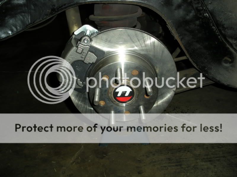

Finally assembled
The rotor hat is a little thicker than the drum. So now we have more clearance between tire and frame. I'm kind of wondering about the 29.5 tires though. :-k I might have to get the hammer out O:) =;
I hope this helps anyone thinking of the change over.
