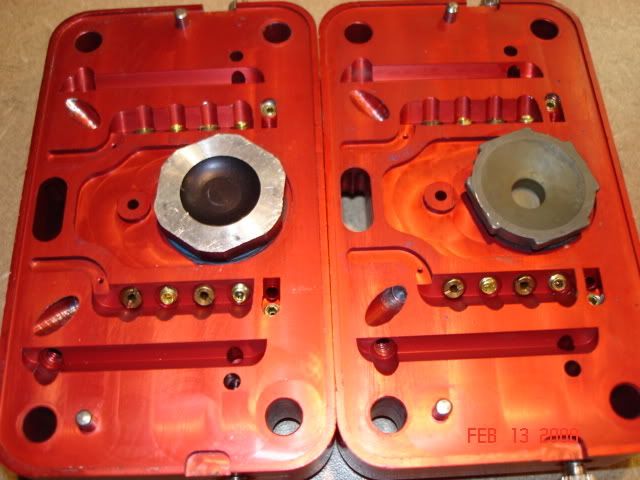

Here is the metering block that I used.  Both have the same part numbers.
Here is the location of the IJ or (idle jet).  One at all 4 corners like this.
Here is an E hole or (emulsion hole) and it is .028 in diameter at the bottom and is open.
Here is another E hole and it too is .028 and open.
Here is the location of the crosswell or angle channel.  This is what gets drilled out to .159.  Mine were .145 OD and I didn't drill them yet.  I wanted to wait to see if there was a fuel problem down track and I'll find that out with the O2 sensor this spring.  The plug read that I did last fall didn't show a lean condition and was actually a little fat so I may be OK at that.
EDIT: I did finally open these up to .159
Here is what is known as the "kill bleed" and you will need one in each crosswell on the primary block only, but, if the secondary has'em that's OK too.  You just don't need to add them if they aren't in the secondary block.
This is the PVCR or (power valve channel restrictor) and it opens into the mainwell just above the main jet.  Two holes there, one on each side and don't worry about the secondary block on these as there is NO PV in the secondary.
This is what a "HIGH FLOW" power valve looks like.  If you're going to use a PV then this is the type you want.  This one is a 6.5
This is the location of the TSJ or (T slot jet) and there will be 4 of those as well.  Just remember that the one on the other side will be a mirror image of this one, ie, both TSJs will be toward the center of the carb.
Hope this helps for those of you that will be using a standard 4150 Holley metering block.

Very good decription and pictures Ken.
Just remember to tap a little, then check the installed depth, most of these jets will cause a problem if they are installed to deep, aim for flush, and I think it's worth the extra time and effort to have them matched up as far as installed depth.

Ended up using a small punch to stake the 3rd thread from the top on those 6-32 set screws in order to keep them from going too deep into the main well.
