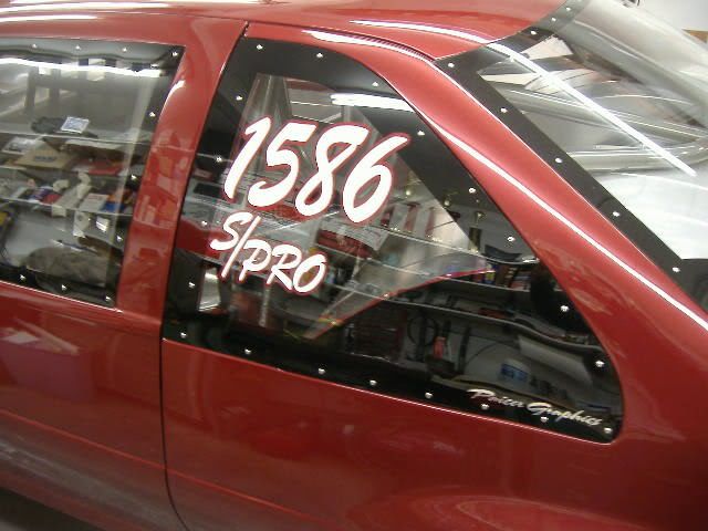

Even if a f/g door has a window frame we cut them off as they rarely fit correctly, but also look real nasty as they are way too wide.
We use a 5/16" chromoly tube frame to support the lexan window. We also do not use the stock hinges as they are too heavy. We make the hinges from scratch again out of chromoly tubing.
Fitting a car with f/g doors, lexan windows, inside door handles, latches, window frames, hinges, aircraft window latches, etc is about a 40 hour project.
Parts alone run close to $1500.

I got to work Saturday to discover I was out of some tubing I needed to complete the back of the cage. So I was forced to do some small work instead. I made some brackets to remount the Wolfe anti-roll as well as making some braces for the upper control arm mounts.
I got the needed tubing today, so tomorrow evening I'll get back to work on the rear portion of the cage, then work on remounting the anti-roll bar.

Just a quick update showing the work completed today. I got the anti-roll bar remounted as well as completing the upper control arm bracing and the X over the shock mounts. The only structural tubes left out back are the two going from the shock uprights to the trunk which will incorporate bungs to allow weight bars to be attached.

Not a whole lot to report other than I got the two rear bars installed. I then completed the top welds on the cage.
I've had a few ask me how I was gonna complete those welds in the roof area. What I did was lift the body up 4" which gave decent room to finish the tops of all the welds. Being a full frame car made this much easier compared to a unibody car where this wouldn't be possible.
