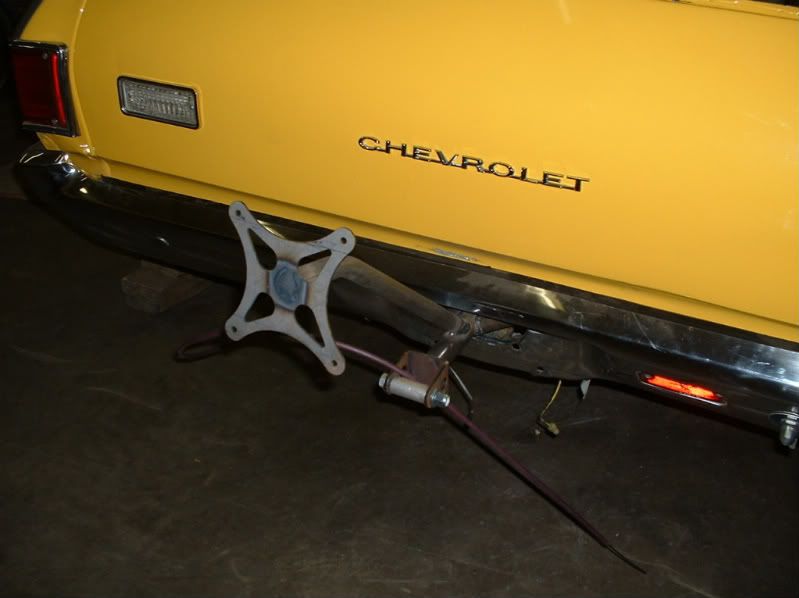

 Post Posted: Tue May 18, 2010 5:42 am
More pics here 5-15-2010

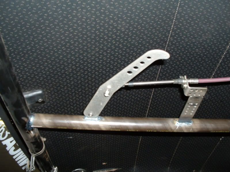

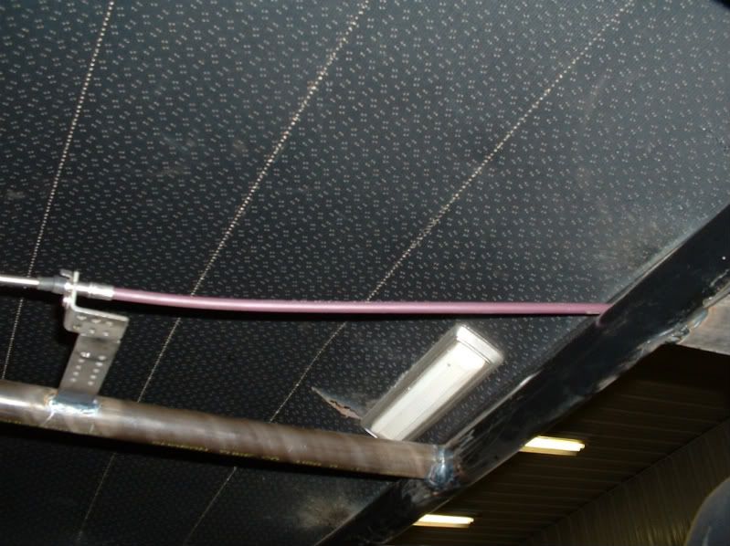

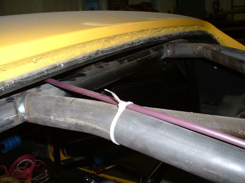

Got the parachute lever bar welded in and the lever installed, and out the back window area.

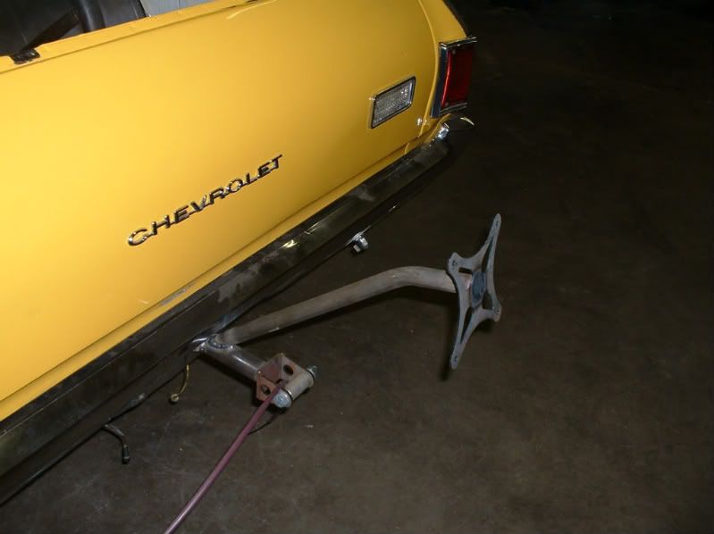

Here is the chute mount and cord attachment also.

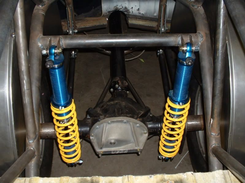

New Afco springs are on the shock now.
Houston, we have a problem!!!! well since I had cut up to 2 full coils out of my Moroso Trick front springs, the pass. side decided to go laime on me and it sagged down a ton, so now the chassis is not even close to being level in the front end. I am getting the springs rate checked this wek to see how much of a differenct they have in them now, but I think I am just going to bite the bullet and buy a set of Santhuff springs made to fit my front weight and all, they seem to have there crap together and I have read much about the racers that use there parts and all are very happy and glad they switched.

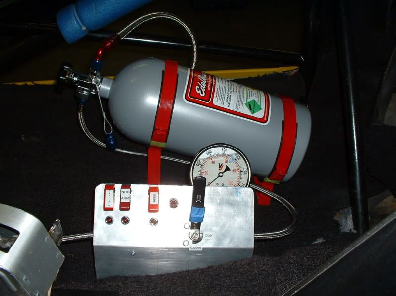

I put my new circuit board and panel of electronics in the car again, along with the nitrous bottle and it's control panel and hooked up all the newely made Nitrous lines to check for fitment and all is good with that. Still need to plumb the fuel line to the back, and install the cell and pump and all the lines, then run the wiring back to that. I still need to install both batteries and hook them up to the kill switch also. I will start to wire the car this weekend coming up and get the fuel cell & pump in also.
