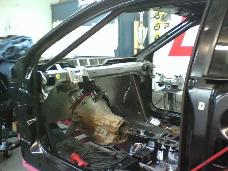

This started out to be a SS/GT car, but since it has 4 doors it isnt allowed, so now he is going the prostreet route and have it legal to 7.50, I have one tub in now, will get the other in this week and then finish up all the tube work and start on the frame rails going forward.
It came out of the factory as a 2007 Saturn Redline Coupe.

 Post Posted: Sat Apr 05, 2008 4:28 pm
Joined: Tue Apr 18, 2006 7:03 am
Posts: 1444
Here's a recent pic. He will be doing all the finish welding since it will be TIG'ed and I'm waiting on him now before the center piece gets cut to fit and tack welded in place. He's on a Cruise right now .... must be nice

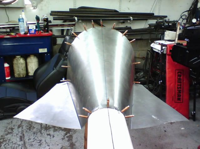

 Post Posted: Sat Apr 19, 2008 3:44 pm
Posts: 1444
I made this to form the driveshaft tunnel piece and the " Dog House ".
Dog House all formed and ready for some trimming. It will be welded into the car.
