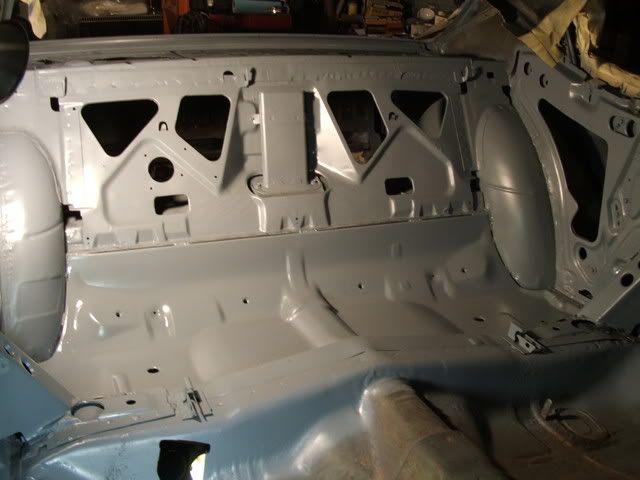

 Post Posted: Wed Feb 14, 2007 8:47 am
support brackets are welded in and primed it is off to the trunk. ready for seam sealer.
 Post Posted: Wed Feb 14, 2007 9:07 am
Nice Tony :-$
 Post Posted: Wed Feb 14, 2007 9:27 am
thank's, that was alot harder than i expected.
 Post Posted: Wed Feb 14, 2007 9:40 am
Boy that looks real nice tony,, good job,, Looks good with some paint on it..I like the Napa brand of seam sealer.It's more workable and dries fairly quick but stays plyable =; =;
