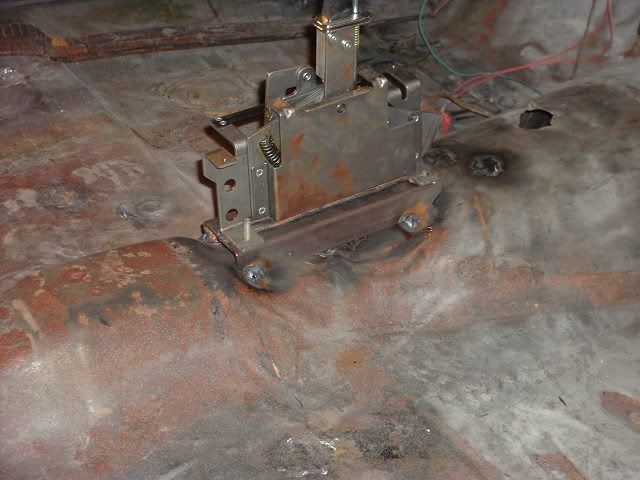

welded up a shifter mount for the b&m mega shifter. welded 8 holes in floor where other shifters were mounted before, have to weld up that hole in front of shifter that someone hacked through for old shifter cable. welded two pieces of angle together 1/4 inch apart to get width i needed out of angle drilled the mounting holes and welded bolts to angle for mounting shifter and then welded mount to floor.
 Post Posted: Fri Mar 09, 2007 8:49 pm
Nice job and I guess your feeling better =;
 Post Posted: Fri Mar 09, 2007 11:16 pm
yep, much better, shifting gears now. =;

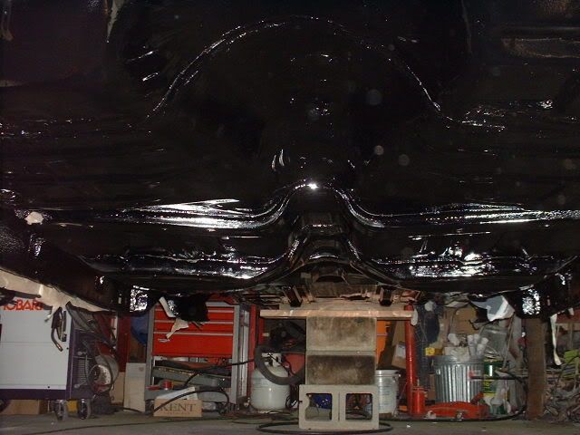

sprayed undercarrige today, gm pitch black.

Lookin good Tony, you think it will hit the road this year?
 Post Posted: Sun Mar 11, 2007 6:27 pm
What Greg said ,and I'll add that that is really black!!!!! =;
 Post Posted: Sun Mar 11, 2007 7:01 pm
i am hoping this year. yep very black..

looks good tony, i did the fram with that por-15 when i did mine about 4 years ago and painted the underneath with just basic black. it's amazing how much a little paint will change the way things look. keep on knocking away at it, and it will be on the road sooner than you know it.
looks great so far!
 Post Posted: Sun Mar 11, 2007 8:39 pm
i used the por 15, primer and paint on frame, did not hold up very well in sunlight, after researching it has no uv protection. so i painted the undercarrage with centari and will probably redo frame with the same.
