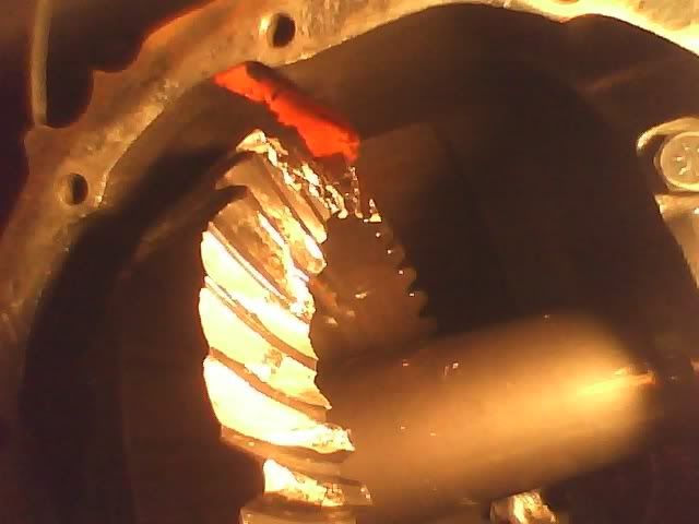

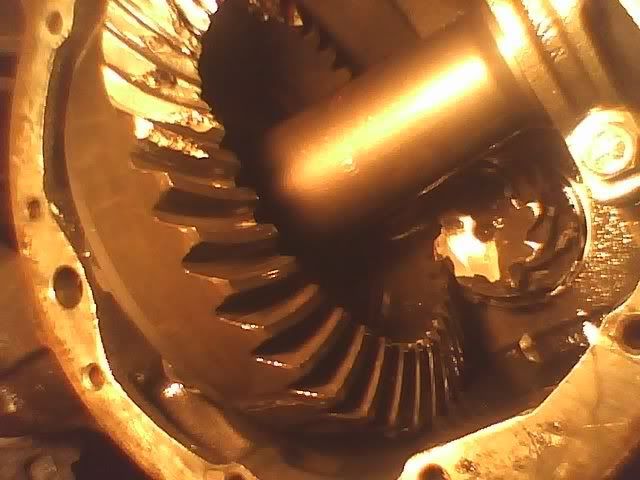

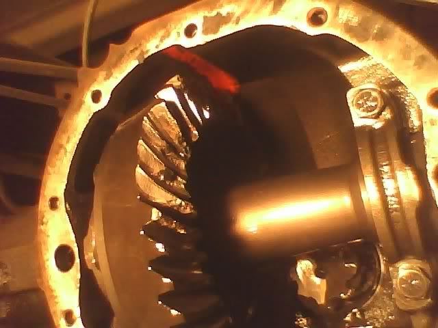

Well I changed the slicks out for some backups I had that have more tread left on them but they are 1" narrower. Made the 1st hit went 6.22@108.5 with a 1.31 60' which is better than it has been for awhile, made the 2nd hit went a 6.20@108.8 with a 1.32 60' went to make the final time run and broke the rear end gears. I will post up some pictures later today or tonight. Have to go pick up a set of 4.56's now to drop in there. Had 4.88's in it. I don't expect it do change anything but they are only $100 so I'll take them! \:D/

Hey theres still lots of good teeth so if you hit the throttle at the right timing you'd be good to go. [-(

Well guys more things to learn I guess. I didn't even make it off the starting line on the 1st pass.
Apparently the rear u-Joint got cracked from the gears breaking last weekend because when I let of the button it just turned the drive shaft into a pretzel and It even hurt the brand new gears.
When we were pushing it off the line it was clunking and it was inside the rear end.
So now I need a drive shaft and gears again. Both caps were still bolted inside the rear yoke but the U-Joint was on the drive shaft with those 2 bearing cups ripped off, in process of this it broke the front u-joint was well leaving the yoke still in the transmission, I hope the trans is ok, going to check on this today... The only positive thing is I ran my uncles truck again and got down to 5 cars and I am still in 3rd for points now only 15-20 out of 1st. We have 3-4 more points weeks left..

Dang Dude when you break stuff you leave no doubt about it. O:) LOL Sucks that it tore all that stuff up. Make sure you get the converter checked also. Ask me how I know ;-)
