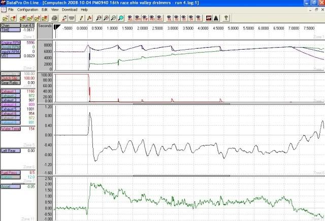

I got my shock sensor all hooked up and ready to give it a try tomorrow if it don't rain all day like today... I didn't touch anything as far as shock settings so I can see how close or far off I was =; ....

Ok, here is the shock sensor graph that had the best short time of 1.226 other run just before this on was 1.231. These runs were just 35 minutes apart and the air was the same...
 Post Posted: Sun Nov 09, 2008 10:48 pm
Tighten up the extension a couple clicks.

I noticed that barry's suspension recovers after he launches and is slightly higher once the car settles. Mine seems to stay compressed somewhat until I let off at the end of the pass. Not really sure what this means?  Of course you can see mine seems to bounce the entire pass, I don't know if the track is just that rough or if  a stick car never really settles down?  I do get a small peak in the graph at every gear change.
 Post Posted: Mon Nov 10, 2008 6:26 pm
Mine stays down too. Without video I would say his IC is too high and too short.
