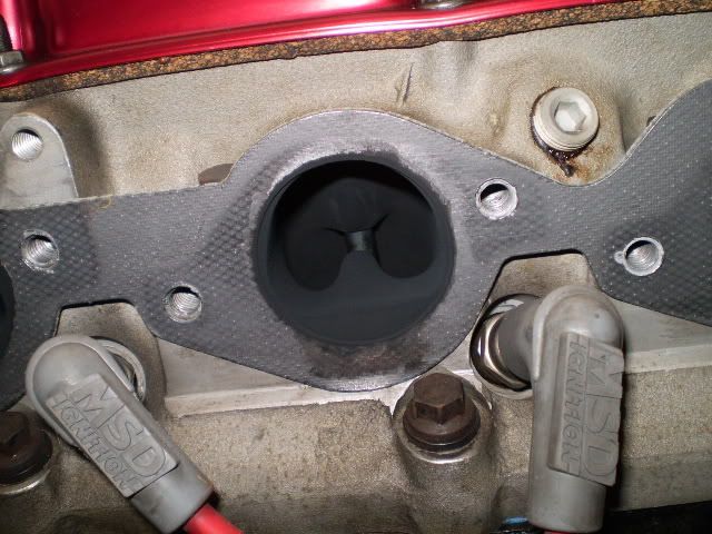

Your exhaust ports look like this??????????With your Dominator???
 Post Posted: Thu Mar 05, 2009 11:18 pm
And with the right carb, look like this.
Wonder where this pict came from... =; =; =;

MY domino is on a 406 with Brodix 18X heads....small cam...motor only made 681 with BG demon. After the dyno we swapped intakes, brodix, and put the P.S. 1050 on. The absolute only change we made in 2 years is a high speed change. Our exhaust ports and collectors look like pic number 2...my P.S. 1000 hp 4150 on my 388" 4.125x 3.625 motor looks the same...I have jetted it, only after taking it from my cawl hooded door car and sticking it in my digger with the scoop. ..the exhaust also looks like pic 2. I guess I'm lucky.
