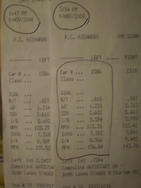

Here are the tickets from the last time out trying to get the shocks set up right and get rid of the tire spin/screech and some more down force down track. Looks constant to me even with the alternator on all the time and with the suspension not right, messed up 3 circuit carb and a cold track........So what do you think Scott????

Scott Smith wrote:
Quote:
Yep and won't run another bracket car without one... Ever put an amp meter on your car with everything  on including the transbrake???? You may be surprised to see what the AMP draw is d'oh! ..
How much horse power do you think that alternator uses? And how is it possible it uses it consistently?
I'm walking out the door to the Turkey Trots. See ya later! Image
I've taking the belt of alt and put it back on and seen no difference other then voltage gauge.  I would think the alt would be more consistent then not having one, constant voltage to ign,delay box,transbrake would make things more consistent right ?

 Post Posted: Sat Nov 29, 2008 7:47 am
My thoughts also...
