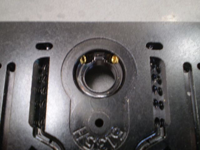

Thinking I would just make them square...92's or 96's and go from there...There been some talk about plugging the PV channel with a set screws so they don't draw fuel from each other.Mark and Bruce have been doing this and I did it on my gas and E85 carb.

Is it a good idea to plug those then when u plug the block? I run tomorow and have a plug in there now front and back but i could plug those holes too, what is the reason for this? What does it do if not plugged , but the plug is still in there?

The plugs in the PVCRs keeps the two mainwells from drawing from each other. Since there is NO fuel available because the PV is missing, then if one booster happens to pull a little harder on the mainwell, then that open PVCR can draw fuel from the opposite mainwell.
All this "could" make one side richer and the other side leaner. If they're blocked, then if there's a stronger booster it can't draw from the other side.

Well pulled the blocks and put the plugs in the channels. I figured it can't hurt.
