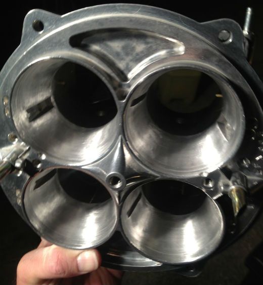

Well I'm in the process of making the changes to see how it responds. Not the prettiest job and I'll probably work it a little more, but I'll do some flow bench testing first.

Not the best picture Mark but are you opening it up down to the step above the throttle plate?
Thinking your also going to have to modify the legs on the banjo's also as they already stick
out..

I'm trying to get more air through this 1450 center section, the venturi was put a bit high in it. This makes the booster in the way, killing a little airflow. I just put it down to the tail of the booster like a Holley normally is, I had to take out .055 to do it. I took the picture last night, I'll try to get a better one.
