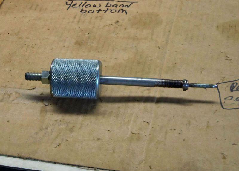

 Post Posted: Mon Oct 08, 2012 3:12 pm
This is a pic of my booster stake pin puller.
Ignore my sloppy welding job. The screw is a 10-32 thread. I tap the stake pin and pull it out with the puller. It takes surprisingly little effort considering how hard they are to pry out.
My initial reason for threading was so the pin may be re-used in an emergency. The threads aren't deep but, I no longer think that is a good idea. The threads my upset the flow. Maybe a self tapping screw may ne a better idea.
