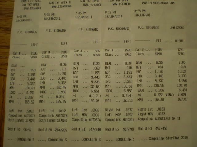

I can't believe how constant my car is. I made 4 runs Saturday and my short times were 1.175 to 1.177 and et varied only 1 hundredth and that was because my trans was at 180 as I forgot to turn on the fan on :- .. Do you have a temp gauge for your trans??
Here's a couple time slips from a T&T and a few on race day..Driver was not hitting the lite very good ](*,) and all this is with a garage built 1150 on gas with the help from members here with the tune and our mentor Tuner... =;

You dialed 8.30 and never went any faster than 8.314.
That's leaving a wheat field on the table for someone to get inside of. [-(
 Post subject: Re: vacuum pump
 Post Posted: Thu Jun 28, 2012 8:05 pm
Yea I know but that was last year and the air was getting better but it never picked up any...
