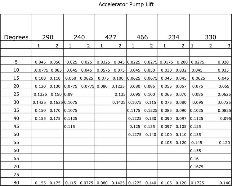

Found this in an older Holley book, and put it in a spread sheet.

Thanks Mark, I printed it for future use.
