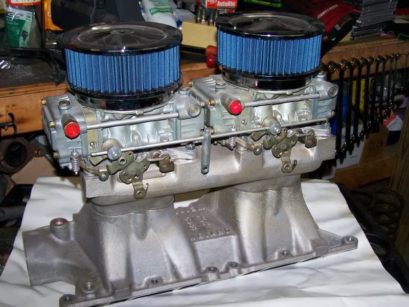

For a street/strip 351C based combo. I did a search but didn't find any info on the 450 Holleys. The dual 750 Dominator tunnel ram combo that I had planned is currently "on the shelf" for awhile. I was thinking I'd be better off running a set of 450's that I have on the shelf for the time being. I bought the 450's last Spring from a local that had purchased them new from Jegs a couple years ago. He installed them but never really drove his car other than in the driveway.
I figured they'd need gone thru with new gaskets and I have a set of 50cc pumps to put on the front pumps. Any other mods to factor in? I'm planning on mounting them sideways with a Hilborn street scoop.
For linkage I was thinking an Enderle or AED tunnel ram kit.
Thanks for any info/help!
Tater
Here's a pic of the carbs/ 302 intake.

FYI, I ran a pair of 1850 600cfm vacuum secondary carbs on a Weiand tunnel ram on my 434 SBC pump gas engine Studebaker when I first started driving it. I had them setup inline with progressive linkage and only used the rear carb's front 2 barrels for around town. Worked very well on the street but left a lot to be desired from a racing point of view as that car only ran 11.20s in the quarter on that setup and the original camshaft for that 434 CID pump gas build.
IMHO the 450s really don't need the 50cc pumps! If you tune the vacuum secondaries with the diaphragm spring kit that Holley has you can get them to open at a faster rate but where they won't bog and it'll run better also.
My engine with a cam change and two 750s was right at a second quicker a couple of years later.
Oh, and I've used that Enderle tunnel ram linkage on a few engines, including the one I'm running now and it always worked well. Last setup I bought came off of fleabay if memory serves.as that car only ran 11.20s in the quarter on that setup and the original camshaft for that 434 CID pump gas build.

The 450's don't have a vacuum type secondary. But I know what your saying with using the secondary vacuum pod spring kit. I "thought" the 50cc pumps on the primaries would be a good addition to help with the "cover-up" to the tranistion spot with the large plenum of the intake.
Just trying to maybe figure out what might work and what won't before I go putting parts together. FWIW, it should be only a low to mid 10 sec NA street/strip Foxbody in the end.
