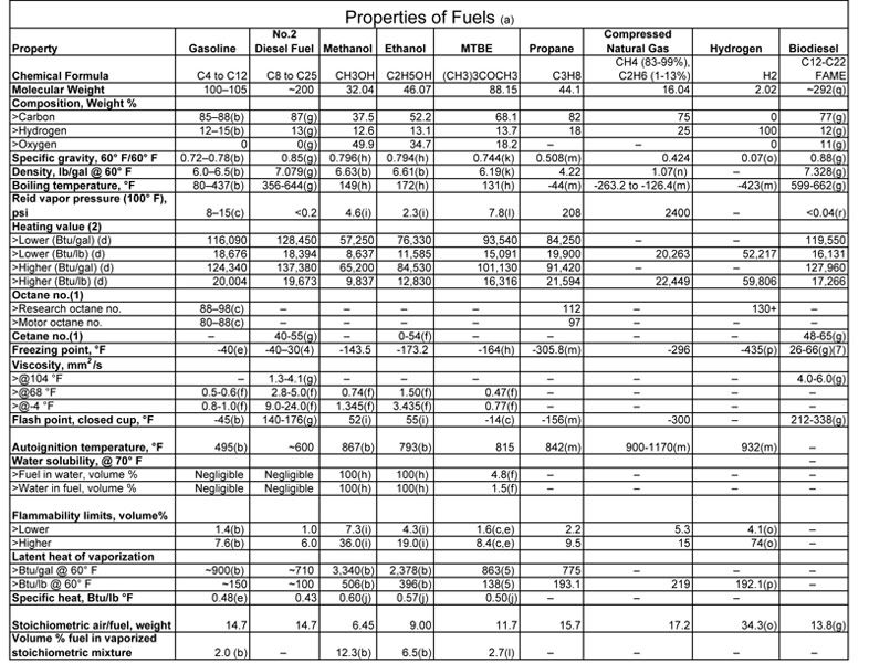

So the cooling effect of the Ethanol will prevent detonation?
My engine will pepper the plugs with 110 Motor Octane and 27 degrees of timing.
114 Motor Octane does fine.
The compression is exactly 15.3 (No estimate)

Excessive heat is what causes detonation. If you look at the table below, you can see how much heat is absorbed per gallon to vaporize the fuels, Latent Heat of Vaporization. Big difference.
I think your engine is right on the cusp of where it could be successful with a fuel that has higher latent heat like alcohols. to achieve that success though you would have to improve the homogenization. Its not only compression ratio that you have to judge engine by for fuel spec. 15.3 can be run with no issues on methanol in the right circumstances. A tunnel ram engine like yours can do it easy. Single carb may not due to runner flow differences along the engine that are unavoidable.
The thing to look for is does it pepper all the plugs the same amount and is the power there on the lower MON fuels once you back the timing off.
The cooling effect of ethanol is a variable thats related to the homogenization and vaporization. If an engine has lower levels of either then it becomes more likely to detonate and will require higher octane fuels to counter that. The less vaporization there is the lower octane is the gaseous environment. Low octane chemicals are lower distillation temperature stuff (as a general statement) for liquid state room temperature HC's. The trouble with E85 is its got junky street gasoline low temp chemicals in it. If E85 was made with race unleaded that would be excellent but then it would cost heaps more.
