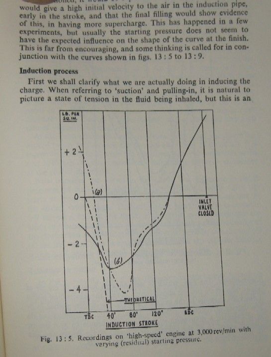

A little bit of proof that I have might be in a book I have (Smith??, IIRC) that has some cylinder pressure traces from a running engine. It shows the effect of late intake valve opening on the end of cycle pressure spike. When the intake valve opened late, pressure passed and went higher late in the cylce (BDC) just when you need it. This testing was done on a lower speed engine (3000rpm or so), but I think the trend would apply to higher rpm engines with bigger ports.
Obviously there is a happy medium to this. Pulling negative pressure thru the cycle also costs hp.
I'll try to post a pic from that book.

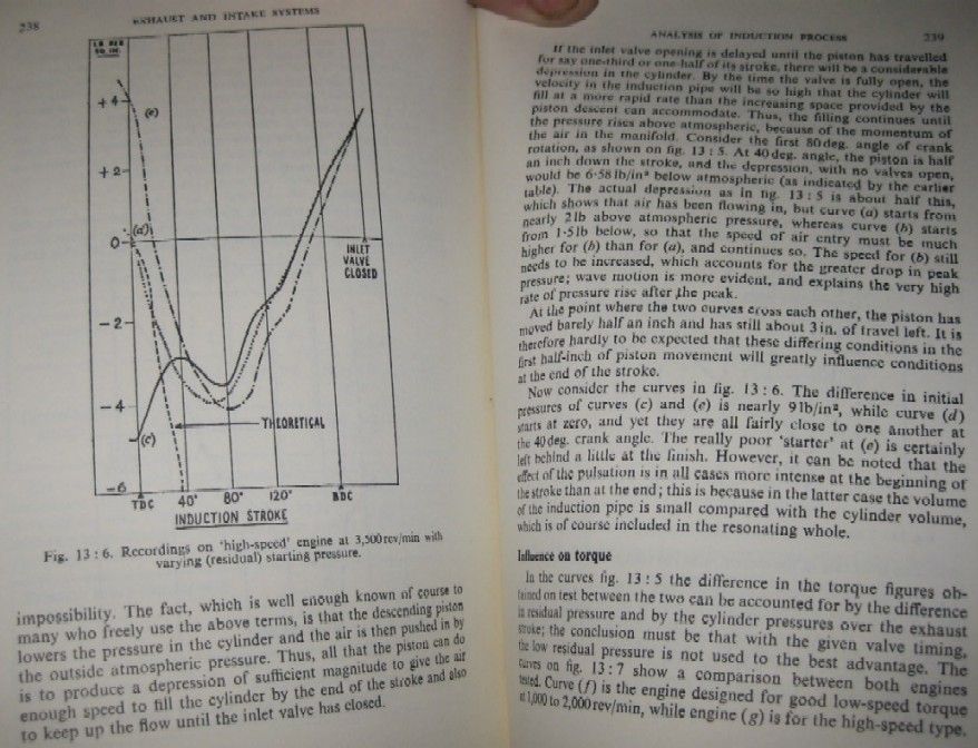

Is this "proof"? Maybe for that particular test engine only. It does lead me in a direction. I think the second half is more important than the first half of the cycle. Can it be better if it is all perfect ??? I am sure it can.
These are from the book Scientific Design of Exhaust and Intake Systems by Philip H. Smith and John C. Morrison.
Make sure to read the text associated with this one.

thanks alot for taking the time for the pic rick , i wonder if the valve is not open as far at max piston speed with a wider lsa if the pressure differential would cause the ss to seperate sooner , - tom

It probably would have more dp at max piston speed which is good. Lots of velocity at 45ºatdc won't help fill the cylinder. Lots of velocity at BDC will. If the port keeps up perfectly with the piston demand it can't overfill it.
If you make the short-turn right it won't separate at high dp. =;
