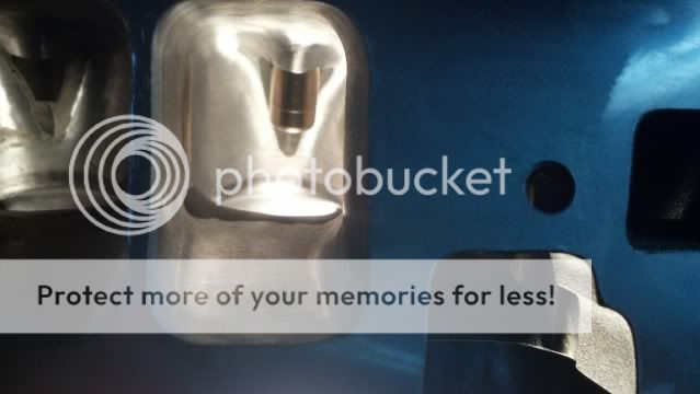

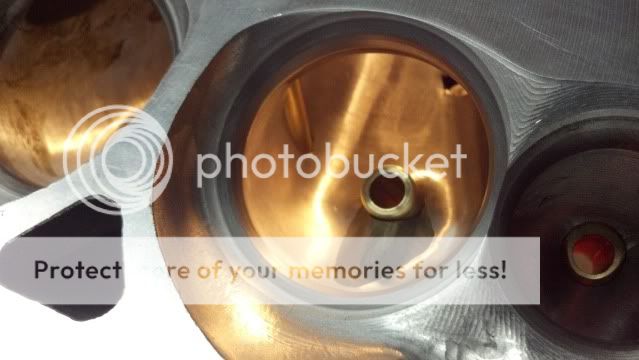

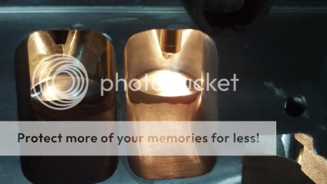

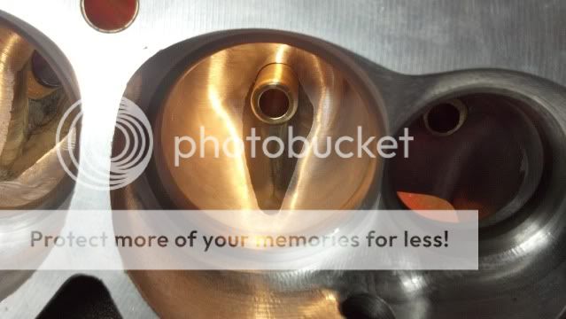

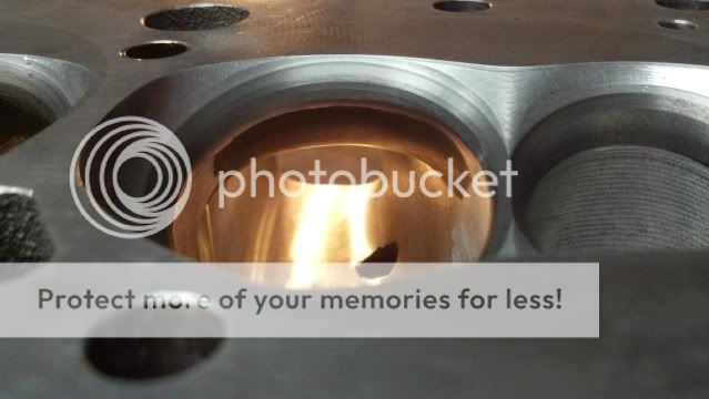

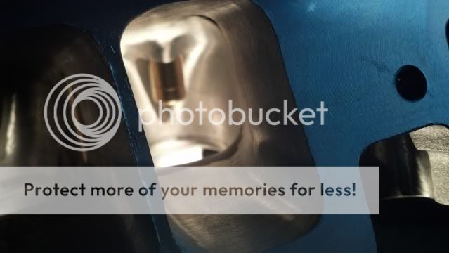

Been working on a pair of these Edelbrock heads off and on for awhile. These started life as a Chapman CNC port that I revised on the intake side cause I felt it was lacking, ended up gaining 35 cfm! Put some epoxy in a few different areas after trying to figure the port out, these are pry worthy of a CNC program for their size.
2.80 MCSA
300 ft/sec at Pinch
2.135 Valve
90.5% Throat
.100 - 80.0
.200 - 166.4
.300 - 231.3
.400 - 281.3
.500 - 320.3
.600 - 338.1
.700 - 345.6
.800 - 351.1
.900 - 355.4
1.00 - 360.1

It turned out decent, I may tweek it some more. I'm doing this set for a motor of mine just need to finish the other ports first. I was thinking about sending them out to get digitized.
