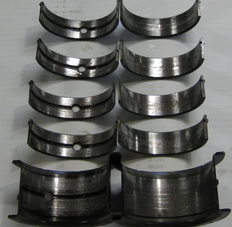

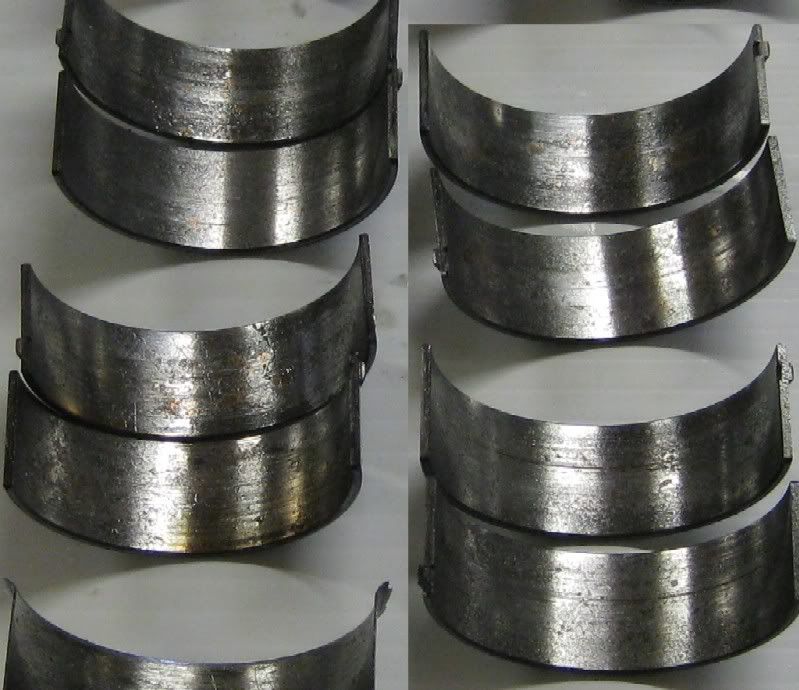

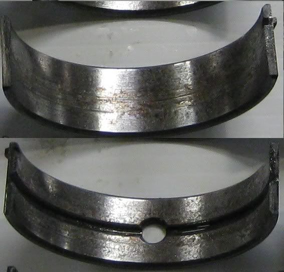

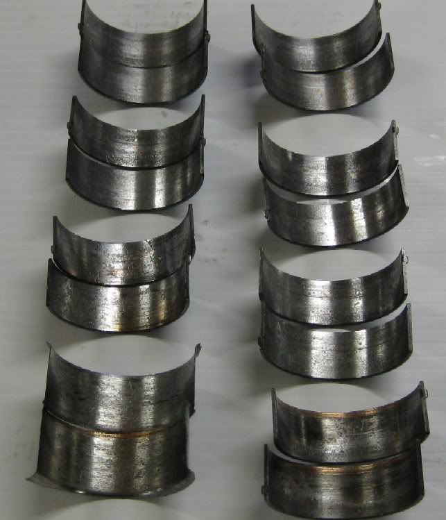

Here are some pics of the rod and main bearings. What does this look like to you guys? The upper and lower bearings on the mains and rods look about the same to me. Would detonation cause both bearing halfs to look like this?

I'd like to see the domes of the pistons of this engine if possible please.
Pix of the main caps and and the line bore of the block would be nice too please. Mainly wanting to see the mating surfaces between the caps and block.
Same for a rod or 2 also?
Possibly the mains were walking a bit and some of that flaking was nice enough to share with the rods,...maybe?
Which may be caused by detonation as you're thinking.
Don

If those are laid out as they came out of the motor I would say the majority of it is contamination (bearing material). The rear main and 2 rear rods seem to be in the worst condition. To me those would be the last to starve for oil but the 1st in line for contaminants. I guess the big question would be is what caused the bearings to fail and contaminate the oil? I think you stated initially you cut the filter open and found nothing so it would have had to have the bypass open at some point. Looks like it spun the one rod bearing so I would have to look close there for something that would have caused that bearing to fail. Maybe lean/detonation on that one? The only other thing is those 2 rod bearings on the bottom in the pic have a little brass showing on the edge like maybe they didn't clear the radius on the crank. I don't want to insult you but is it possible those were install wrong and the narrowed part of the bearing was facing the wrong way?

Those bearings are nasty! Looks like they've been dipped in acid.
Don't worry about insulting me, if you think something, say it.
I thought it looked like contamination myself. My oil filter bypass was always blocked. Then when I put the accumulator on it had a special adapter to connect it in after the filter. I've thought a lot about whether it's better to plumb it before or after the filter. I chose "after the filter" at the time because I thought the oil filter check valve would keep the oil moving in the right direction. I now wonder if there was dirt in the new accumulator??
The bearings are laid out in pairs as they came from the engine. The spun bearing was #7 and the one that has the edges to copper was #8. I think #8 edges were damaged from the #7 bearings flattening out into the #8 bearing on that side.
In the process of cutting the filter open I didn't really look for tears or if the filter was intact internally. Maybe the filter was broken and letting dirty oil get thru?? The filter is a AC Delco PF1218.
