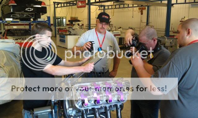

Hi Nick, we talked to several of the guys on the Hot-Heads Hemi team back in the teardown building so I probably talked to you. I know Scott now (dieselgeek) but I am not sure which one of the guys you are for sure. Are you the bigger guy in the bunch? If not which one in the team pic in the PHR article?
In the pic at this link from the EMC I am the one with the blue sweatshirt and light tan hat changing the air bleed. Randy has the black Chevy hat behind me and our friend Tommy on the left who got roped into going to help out.
