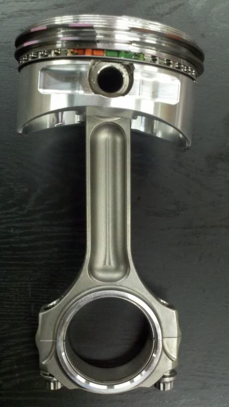

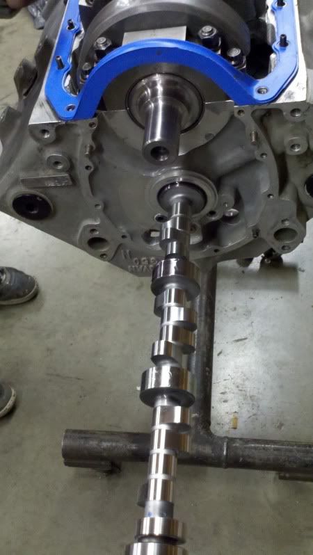

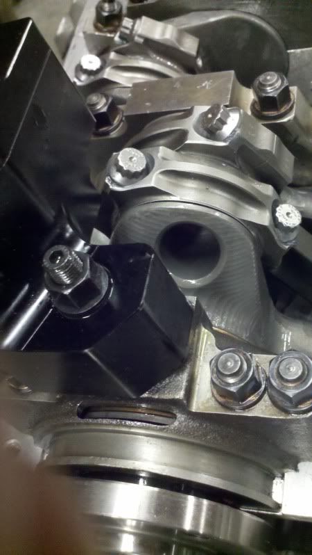

hey guys i thought i would post an update on my progress, the shortblock is assembled and back in the car,it consists of Oliver 6" billet rods,Callies dragonslayer crankshaft(3.750),JE nitrous series dome pistons(4.155),JE .250" wall wrist pins,JE proseal rings(hellfire),ACL bearings,Moroso billet oil pump,Moroso eliminator pan,and a comp cam custom ground for this application...4/7 swap-.900 base circle-.697/.696 lift-270/278@.050-114* lobe separation this cam is built for up to 650 hp of nitrous...and we have the plate and fogger on tap for this year =; ....my wife said i could not build a 7.50 chassis for the vega until it outran its 8.50 cert....done!! =;

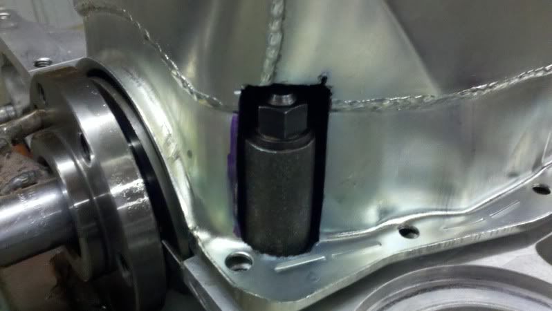

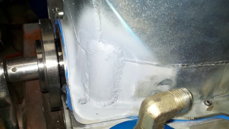

Jeff, Did you make those T type handles to hold your VC down??

barry, yes I made those out of 3/8" stainless tubing with a stainless nut welded on the bottom.....im cheap =;
