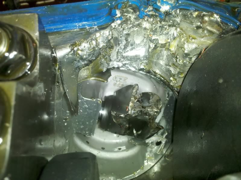

does this look bad ?
im no engine builder(obviously),but im having a heck of a time keeping oil in this thing.....do you think i should get a new pan? =;

i took the pan off to see if there was a problem but i just found a few aluminum shavings O:)
 Post subject: Re: oil pan problem
 Post Posted: Tue Feb 01, 2011 9:26 am
Looks like a ring broke........Bet that is the issue why it won't turn over :-k

OH s**t! Probably won't use that block again, hey! So how did this all happen? Bearing seize and break that rod...................???? How about the crank?
 Post Posted: Tue Feb 01, 2011 6:24 pm
ha it did put a hole in the header tube....that is mine ken,it did not appear to lose any bearings but one of the ohio crankshaft rods had enough....the block is welded and at the machine shop now...6 new liners and im back in business =; the parts going back in are AMERICAN this time....it lost the crank,rods,cam,oil pump, oil pan and pistons but luckily it did not hurt the heads

What Ohio Crank rods? H-beam or I-beam? Weight of rod? Did it break in the middle like it looks?
How many rpm did you turn it? What's the stroke? Piston weight? How long have you run them?
Just wanting to see the level of abuse they received. I'd think most of the China rods use the same forgings so makes me wonder how much mine (Compstar) might take. #-o
