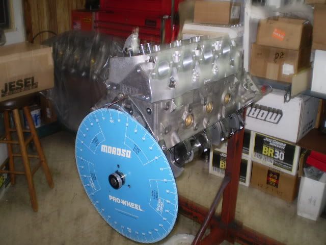

The new motor.......and I say new cause everything is new...540 Bowtie block,Wisco pistons,Oliver rods,Callies crank,Brodix BB2Xtra heads,Victor manifold, 1150 dominator that I sent to Mark in Florida to check it out and he ran
it on his dragster....Hope to make 850 hp...
I have a 8" that has been done over and my be it can be made to work with this new motor but I am thinking a 9" will work better and be more constant and that's what I am after...
This is what it looks like for now...
