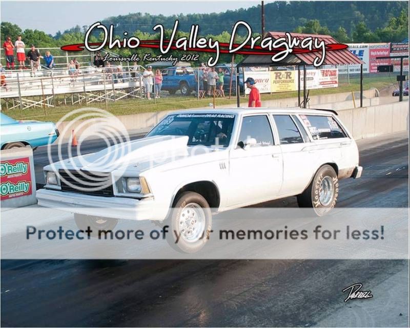

Do you think I need more? 18 in them now.

No

Are those radials? 9x30s?

Yep. 9X30. 29.9 tall. the 30X9 are 29.5.

I run mine about 18 also.

On this run we had changed the front shocks to 60/40 from 90/10 and I fixed the throttle linkage that was binding while coming up on the converter. It would stop at about 2300 RPM and Jake had to press harder to get by it. Then the RPM would go up to 3k or higher. The car likes 2500. Any-who, Jake had a .010 light to the darts .035 on a heads up 6.97 first round win.

Looks good Steve...
Know a guy that runs a Biscane (sp?) anyway he runs radials and has 22lbs in them O:) ...

I've thought about going higher sometimes. But figure the time I do the track wouldn't hold it. ;-) Maybe I'll do it next time I go to the track :-k

I usually use a heat gun and set tire pressure so that the tire is somewhere near the same temp all the way across after the burnout.
FYI Steve, if you go horking with tire pressure, it's likely going to mess with Jake's reaction times, ie, pump'em up and he's going to go red!! ;-) If it ain't broke, then there's probably no need to try to fix it! ;-)
