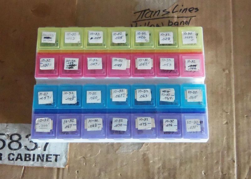

What pill boxes are really for. I have one for 6-32, 8-32, and 10-32. I need one for 4-40 stuff.
 Post Posted: Tue Oct 02, 2012 4:28 pm
OK what's the 4-40 for :-k HUMMMM that seems to be why there is a shortage of brass set screws :-
 Post Posted: Tue Oct 02, 2012 4:39 pm
4-40 for BLP wide body blocks, they use it in the kill bleed. Also plugging some metering block emulsion passages a 4-40 can be used.

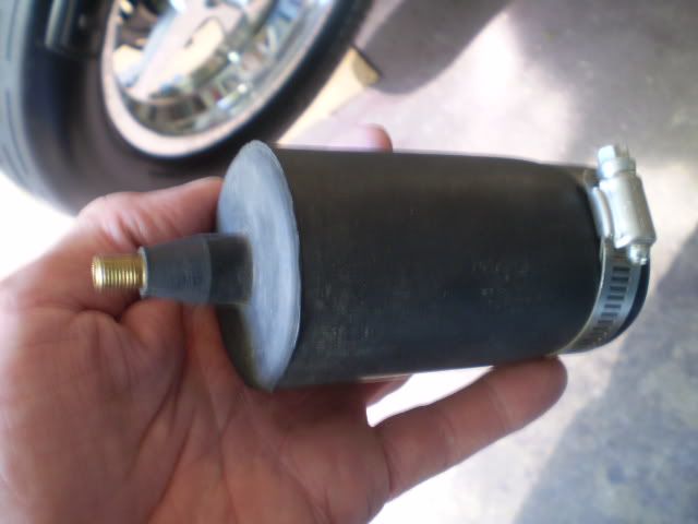

I had a converter that leaked a few drops when I was on it and had a hard time finding it. Long story short I got this from a buddy that works for the phone company. Can't remember what they use it for but I clamped it on the snout of the converter and put 90+ psi in it an squirted some soap around it and there was a small pin hole in the weld on the snout...
