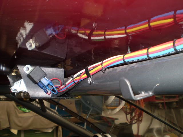

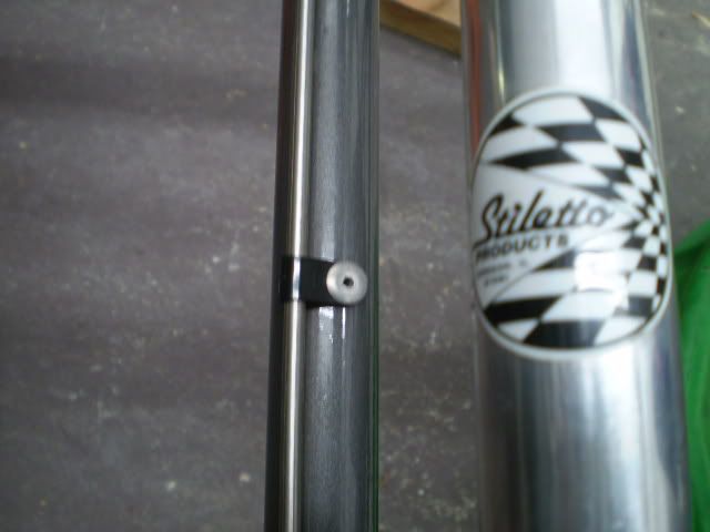

Jeff I drilled 1/8 holes in mine to attach wire to and also the overhead switch box and my logger to. Also same holes for the brake lines...Here a couple pictures...
Ditto here. for bigger stuff you usually will want to weld in a threaded insert.
Heck, on the closed tube ends where welding is done, my chassis (Willie Rells) drilled 1/8" holes for the welding gas to escape.
