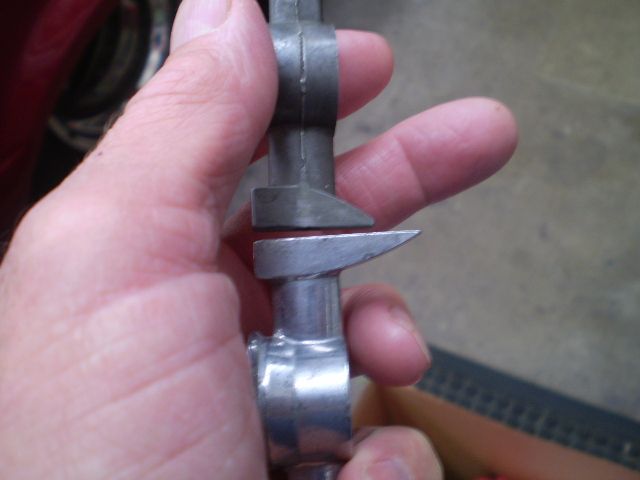

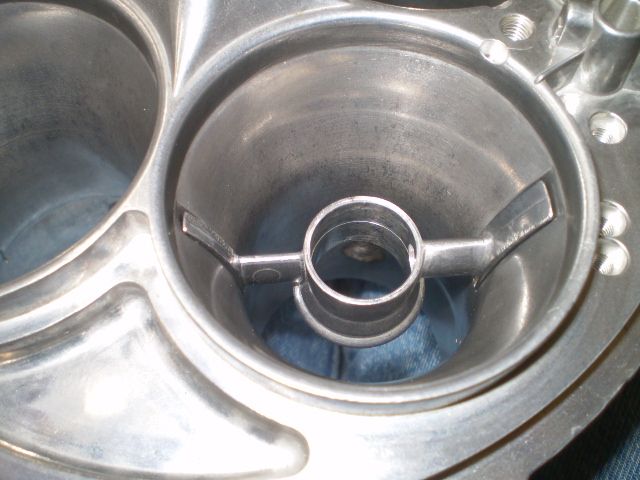

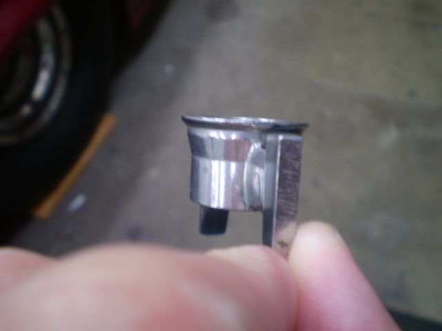

I got this QFX main body from our Carb parts guy Bruce (nomad) and was looking at the difference in the skirt on the
banjo compared to the BLP that is on the HP carb now..
The bottom of the flair will be gone when I find someone that can remove it and make it .980 instead of what it is now..
QFX Banjo
BLP Banjo

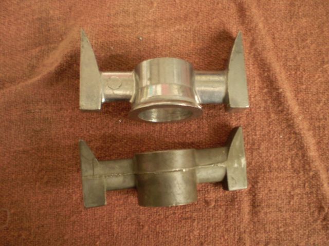

 Post subject: Re: QFX/Holley Banjo's
 Post Posted: Wed Oct 10, 2012 10:12 pm
They look like this.

Not really Mark as you can see.. There also longer in length.. The Holley banjo's fit but real sloppy and the QF banjo's and less
money than the Holley/BLP banjo's and the BLP boosters fit the QF banjo's..

The Holley banjo's will fit but as you can see the entrance taper is different. But the banjo's are not real expensive, and the booster inserts are interchangeable.
