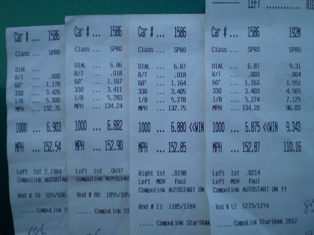

I made it to the track this weekend and wanted to go Sunday but had family plans so Saturday it was and it was a race day so alot of changes were not in order,,Started out with 176 jets square and that run was a 7.01 at 150mph yea slow so after making a couple jet changes I am at a 164 jet now. May still be a little rich but it picked up nicely at a 6.88 152mph =; and my short times went to 1.16 when the track came around. Remember we only race to the 1000' :- ..It's looks to be just as deadly as with my gas carb as far repeating \:D/ \:D/ . Last 2 slips are race runs in witch the air changed about 400ft and picked up .05...The 1/8 mph in the last run looks bogus at it does in the 2nd time run also,you think???
My weekend end was a little better than Kens but 3rd round my trans broke so that ended my day ](*,) .
When looking at my logs I noticed #1 & 2 cyd's have very low egt's and carry them all the way through the run. EGT's are about 1200 but 1 & 2 are only 1000*??? Et slips from the runs..Best part I burn't about 12 bucks of corn oil \:D/ in 5 runs =; ...
Oh John our starting line manager asked me "What are you burning in the thing cause it really stinks" O:) O:) O:) ;-) ........Also here is a plug to look at...So next time out I will go with a 164 jet after a run with what is in there now (168) and see what happens till it slows down some. I will post a log sheet tonight to shoe what's going on with the EGT's #-o .. It also is not real crisp on the burn out and seems to be a slight bit lazy so going to need some help there also..So any idea's let me have them..

Looks good Barry. Sorry you broke the trans.
What are the O2s in the burnout? Can you get that off your logger? We'd want to know that info before making suggestions.
Also, it might be a good idea to start comparing O2s to EGTs on corn so you can develop some relational data.
You're doing good here. We'll talk on the phone this week.

Bruce, Best run in close to same air on gas is 6.96 so looks like almost a 10th quicker \:D/ . And we are not even done tuning it yet \:D/ ...Trans is minor issue I hope but will have it out tonight and apart =; ..
