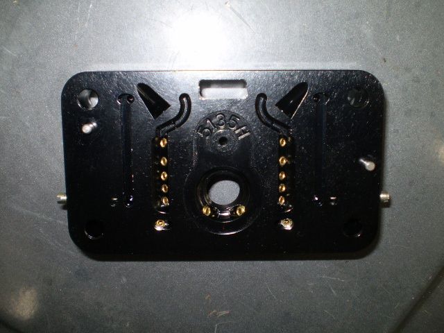

I have the metering blocks done but have a question and I can figure it out if I take a bowel off my other carb but the car is in the trailer and can't get the hood off in there so here's the question..
The metering block vent does not have a hole in the top where the pin holds it in place so where does it go as far as depth?? Kind of looks like it should be flush with the other side but though I would ask =; first...

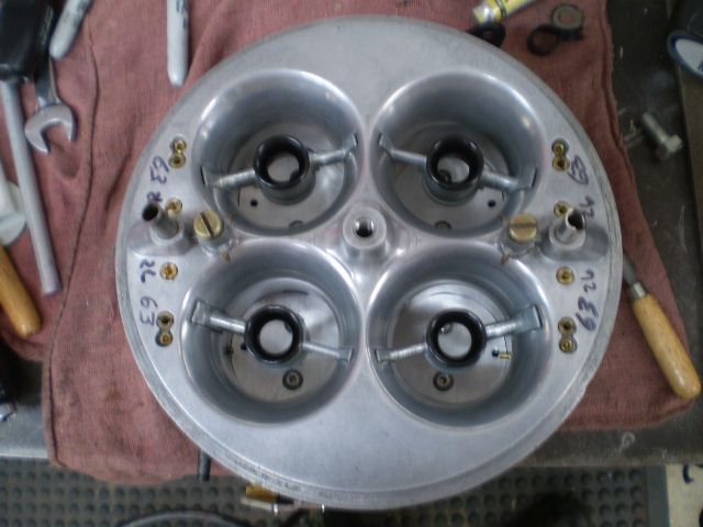

I also got the main body done with the boosters installed..

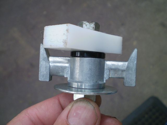

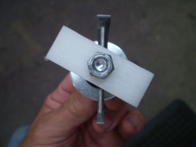

I also made a tool sort of to press the boosters into the banjo's
5/16 bolt with a piece of delrin (sp?) on the top so it don't scratch them up..

Looking good Barry! I think my vents are flush with the main body side of the metering block.
At this rate you'll have the car fired on E85 by the weekend.

Barry, what do you mean by flush?
I'm missing something here.
Forget it. I re-read the post. I do it like mslayton described.
