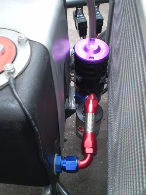

AS you can see it's tight quarters there and didn't want to redesign the fuel system for a different
filter.. I have some people looking for me and need to call the local speed shop here that is local
as he had alot of BG stuff...Hope to get lucky and find one somewhere...

Beretta This is my fourth year on e85 using the BG 500 filter and insert with no problems at all. I had said in another post that some one sells a insert for the BG filter, found that Jegs has a replacement insert # 555-15005. It is listed as a gas filter insert , but looks the same as the BG insert as far as the element. The original BG insert was not SS but worked fine, and BG only had one filter insert listed for meth or gas. If the Jegs insert is the same as BG's, then it shouldl work fine with e85, and its only 12.99. I'am going to get one and see how it compares to the one i have now, i don't have a lot of room for change either.

No foam in cell, cut filter apart, some sort of paper, no bonding glue, pressed between inner and outer metal casings. When i had a electric pump in the car i did a fuel volum test, BG 400, this filter with e85, # 10 line, one gallon in 26 seconds. I didn't see any problems when i switched to e85 with the fuel system as far as loosening up anything in cell or lines
